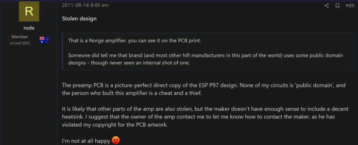

The heat-sinks (in the Norge 1000 Gold Stereo amp) are tiny and not build for 4 ohms load- Rod Elliott's comments
Please can you post a link to Rod Elliott's comments
There are strong rumours, or rather in today's political climate credible allegations, that Norge amps are based on the P3A circuit
They are based (read copied without permission for commercial use) on Rod Elliot's design. Heatsinks are also flimsy, a simple CPU cooling fan maybe required.
"A pair of these amps will be quite happy with a 0.5°C/W heatsink for normal hi-fi use if the quiescent current is maintained at the minimum recommended of 20mA. You will probably be able to get away with a smaller heatsink if the supply voltage is reduced to ±30V, but you have to ask yourself if it's worth it. For higher quiescent current or if you expect to push the amp, use a larger heatsink. Consider using a fan if you are going to push the amp hard. Remember - there is no such thing as a heatsink that is too big."
Power (42V supplies, 8 ohm load)
90W
Power (35V supplies, 8 ohm load) 60W
Power (35V supplies, 4 ohm load)100W
Operation into 4 ohm loads is not recommended with the 42V supplies. Peak dissipation will exceed 110W in each output transistor, leaving no safety margin with typical inductive loads.
- https://sound-au.com/project3a.htm

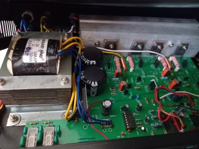

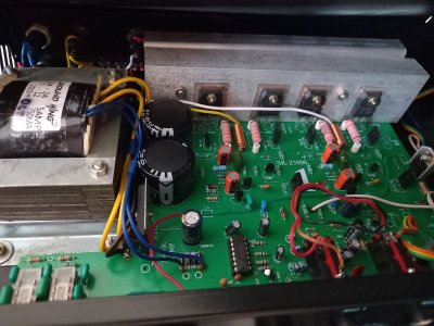

Transformer voltage 24-0-24 AC = +/- 31.84 DC (33.84 -2V diode drop) post rectification, while the capacitors are rated for 35V
