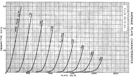

To the contrary valves are much more neutral devices than solid state on their own. You can't stabilize a SS amplifier without some form of significant negative feedback either local or global while valves will work perfectly on their own without any feedback and the circuit will not oscillate.
See the response curve below of an 845 tube - it is perfectly linear. There is no transistor on the planet that can match the curves below.

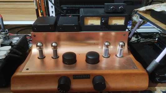

Cadence VA-1 is a very poor amp. It has severe drive issues and will work with only the most sensitive of speakers. Never ever liked it to be honest.
Exactly. Like you, I have never found it to be good. I'm wondering if this could be converted to a SET and reuse the transformer and valves. It is in my mind. Maybe one day.
Cadense are among the worst designs. The Canasya is a ticking bomb, absolutely horrible under the hood. Would not pass a single safety parameter, especially when deploying such high voltages. My friend had to totally rewire and re-engineer it to his satiafaction.

What is the significance & impact of the bottom section of the graph? Where the curves become curved
I opened my VA1 amp. The wiring inside is horrible. The soldering horrible. I was eyeing the Canasya when I auditioned VA1, but the size of that beast and the cost detered me. My ears couldn't find much difference between the two. I was using the VA1 with Cadence electrostat Arista speakers. Currently I'm driving the same with V3 mono blocks.

After seeing the graphs below, anybody will agree 100% with your statement "There is no transistor on the planet that can match the curves below."
Examples of harmonic distortion
If grid curves are wider on one side than another, gain is asymmetrical, creating even-order harmonic distortion:
If grid curves are wider in the center than at the extremes, this causes symmetrical odd-order harmonic distortion:
You can see in these examples that an equal change in grid voltage would not cause a proportionally equal change in anode voltage at all areas of the load line. When the gain is asymmetrical around the operating point, the output waveform will be misshapen, or distorted, on one side but not the other. This will cause a type of harmonic distortion that is even-order. If the non-linear effect is symmetrical on both sides of the waveform, then this causes odd-order harmonic distortion.
You might also consider what happens if the operating point were too far to the left or right on the load line, or if the input signal were too large relative to the span of grid curves—if the input voltage pushes into saturation (near or above 0 volts on the grid) or down to cutoff (deeply negative grid curves, with low or no current), then obviously the output signal will be extremely distorted and a sine wave would appear as flattened on top or bottom. This is what we would refer to as clipping. Guitar amplifiers operate closer to these conditions to achieve a desirable overdrive or distortion sound, but obviously in a hifi amplifier, this is undesirable.
Now, we’re finally ready to look at harmonic distortion another way to visualize these even and odd-order harmonics! I love this part, because the natural world, physics and math are sometimes like magic.
That is outside the typical operating point so it is immaterial. You will normally bias the active device in a way such that it never encounters that region.
