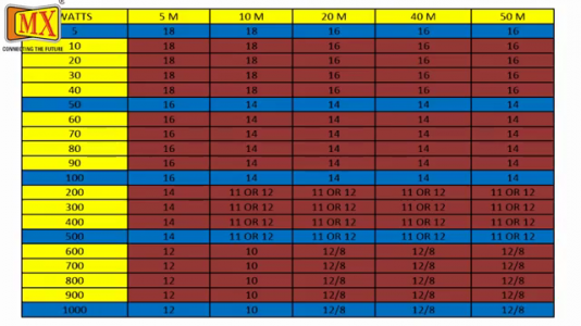

The attached table will help u. The table is by MX. You can go for good quality speaker Cable (OFC) of proper gauge depending on your requirement and budget. I use 16awg(ofc) cable for running length of 3 meters each side for 2 channel stereo set up. I have two amps one is 50w rms per channel and other is 90w rms per channel. I had never faced any signal strength or sound quality problem. Try to terminate the cables with banana plugs/spades depending on the binding post at the back of your component and speakers. This will provide better contact and ease of removing cables at time of cleaning. All the best.
