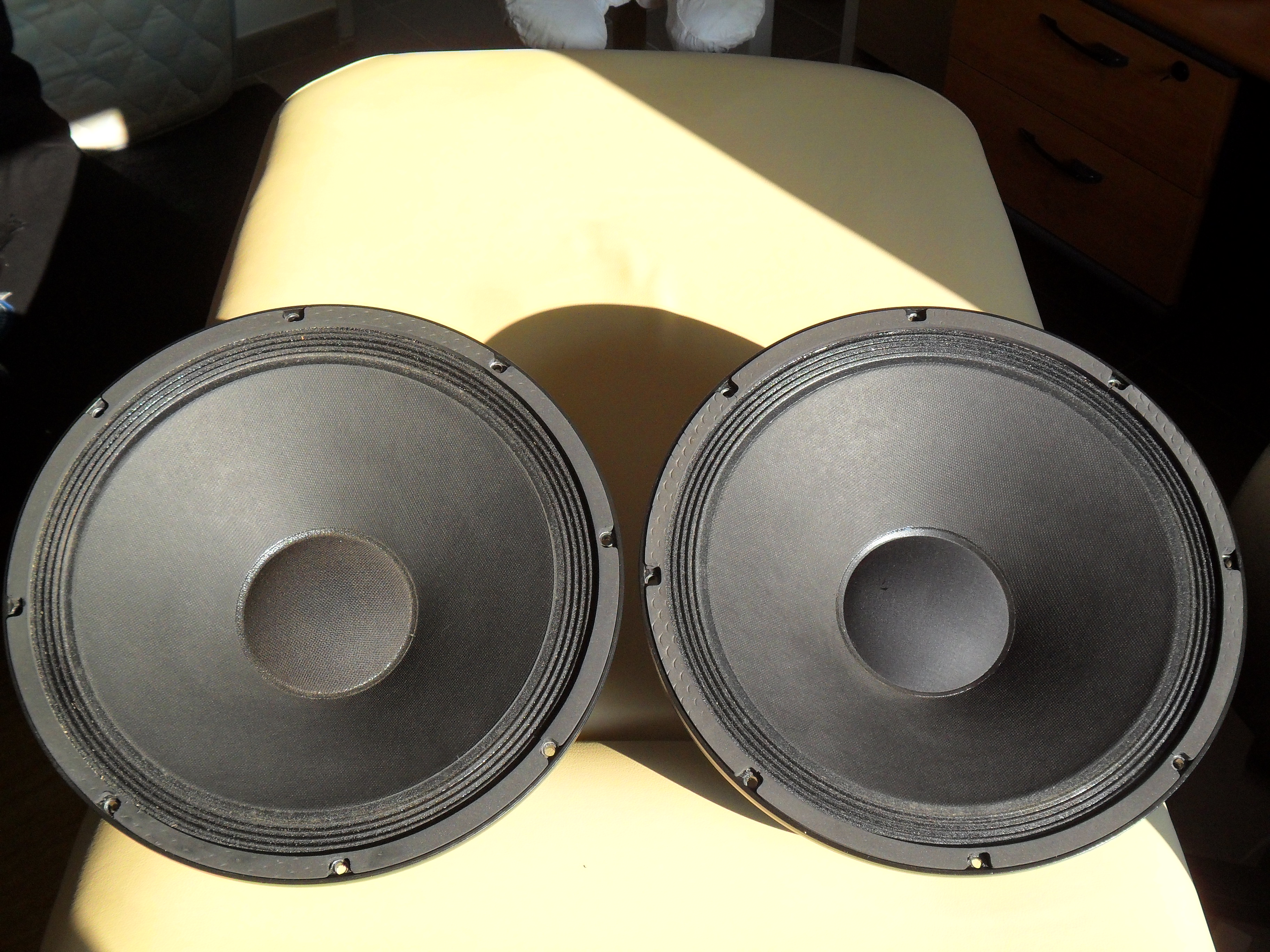

Struck Gold; gotTannoy 15" Monitor Reds
Congrats captain for the find.
These speakers are 16 Ohms so it will better suit a tube amplifier.
Anything above 20Watts would be required to push the large mass these have.
On my 15" MG's I used a SS Quad 520 and modified Quad 405MKII and these sound wonderful. You may not want to hear any other smaller speaker once you get used to the sound of these vintage Tannoys.

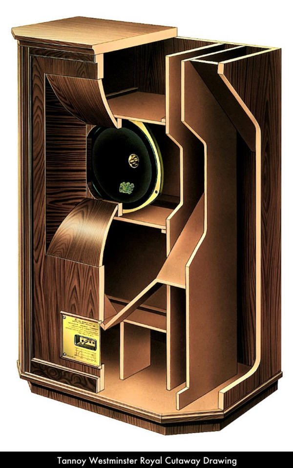

Yeah I love the looks of Westminsters but Rajiv says that they are too complicated to make.
Oh I read your build thread and thought they are 12" drivers. They look nice. You've modelled them to resemble their latest flagship Kingdom Royal speakers. What about the internal volume?

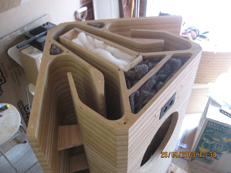

Westminsters are acoustic labyrinth type enclosure. It has various sections forming partitions. Its not difficult to make unless you have skilled carpenter at your disposal.
It can be done, if you want it that way.

@Captain Internal volume on my current MG 15" is 228L
You need to be careful with damping inside the horn. It may become too boomey if you do not use the correct damping material.
I have tried various things and Glasswool 1" thick stapled closely and use of sand box inside has helped me tweak the bass to my liking.
I have tried various things and Glass wool 1" thick stapled closely and use of sand box inside has helped me tweak the bass to my liking.
I will post one photo in my next post.
Thank you for the tip Vinay; have you used felt? How did it fare? What is this sand box and where have you placed it?
Picture would be a great help in understanding these things.

The Westminister design is a really evolved and intricate design acoustically and hence complicated. Once you get to that level of speaker in terms of its sonic properties, in order to get any other improvement the most reasonable would be to get a better amplifier and hence the amplifier would be the bottleneck .It does not , of course, mean that one would not be happy with the current amplifier or spend money to upgrade, just that the speaker itself would be at a very different level.
From what i am reading, typically these speakers are used with higher powered(or high current) SS amps/Tubes/mono blocks to eke out its best benefits although there are enough people who do prefer it with SETs as well.
