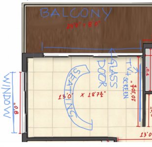

@k-pad messaged me and posed few questions that can help FMs understand my setup and requirements a little better. I have answered those below.
1. You mentioned a French window in your post, but from your picture, there is an open doorway on the opposing side. So, it would help a lot for other FMs also if you could share a bigger layout of the living room. For instance, are there other openings in this space like that doorway in the picture?
I am enclosing a picture below that shows the layout of the room. The French window covers approx 15’ of the left side wall. Wall opposite to the screen has a large window of 8’ length. It has been covered with 3 layers of curtains. One sheer, one blackout and one normal cloth. Blackout and normal cloth have been stitched together. The ceiling has false ceiling with perforated sound deadening boards. The overall outcome as of now is pretty decent and it can be felt when one enters that room.
2. How far will the seating be? And where will it be?
Seating is at a distance of 14’ from the screen. Seating is on a 3 seater fabric sofa. Area between the screen and the sofa has tiling as of now and I plan to put a carpet there.
3. Seating plan: Is is a couch? recliners? chairs? How many people will be watching at a time?
At most three people can sit on the sofa. One easy chair next to it may also be used at times. Considering the spread, I think a 2 way wouldn’t suffice and a 3 way centre would work best.
4. Do you intend to stop with only an AVR-driven system or are you going to be adding more power later?
As of now plan is to put an AVR. I was presuming that it would suffice. However, an upgrade can be considered if the FMs can advise on that.
