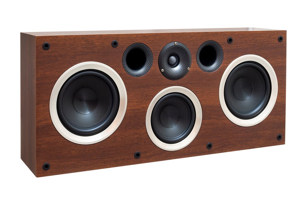

Was considering 3 x identical speakers for my brother for L-C-R, to be placed behind an Acoustic transparent screen in a HT set-up.. Though i did consider and shortlist some models for approx 60K, some models which i use (Taga Harmony Platinum LCR 60 SL) wasn't aval with the distributor.. Also considered some Floor standers.. An interesting model came up.. Taga TAV OW 60 LCRS (3-way speakers) came up.. It is an LCRS speakers, meaning L-C-R-Surrounds, to be mounted on wall..
98f554ff841a416c5e5dcc8a099b7169.jpeg__resize__1900
When the speakers are vertically oriented, the mid-range comes beside tweeter..
Manufacturer recommends orienting the speakers in different position for multi-channel use, which gives some flexibility to the user.. More over the depth of this speaker is shallow, just 15 cms.. Price per speaker is 19K (Hifimart), which was within my budget..
Wanted to give a try.. So ordered 3 pieces for L-C-R, for my brother.. Will share actual product images when i receive them..

Yes of course.. I got 3 of them for L-C-R.. I bought it from hifimart.com. Spoke to Anil (hifimart.com) and he helped me source it.. It is not listed on hifimart.com as it is onwall / installation kind of speakers.. But Anil would help you get them if you are interested.. Price paid is Rs 19,000 per speaker..
Missed to update this thread with pics.. Here are some..
All the speakers are placed behind the 160 inch AT screen, tweeter matched to ear-level..
Yet to add any acoustics to front wall.. Will do so, overtime.. For now the speakers sounds very good to me in the living room predominantly used for movies..
There are two more ranges of the same model (Azure OW-80 LCRS & Platinum LCRS), priced higher.. Choose one depending on our budget, in-case if this interests you..
