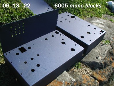

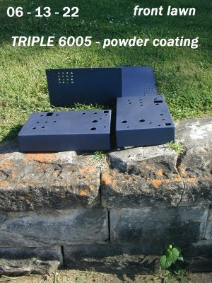

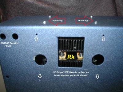

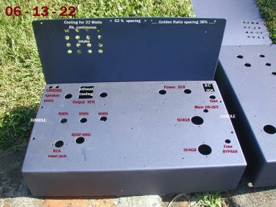

06 - 13 - 2022 ....................... PROGRESS REPORT ............................ Photographic
The two mono chassis were returned from Powder Coaters ( " Sure Coat, ", Sedalia, MO ) today. Dropped off 5-18. 136 miles of driving involved. ( 218 Kilometers ).
14 Gauge steel, with welded corners.
Jeff

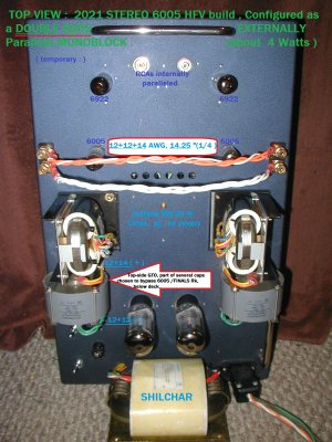

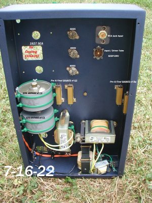

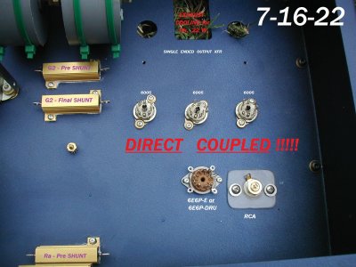

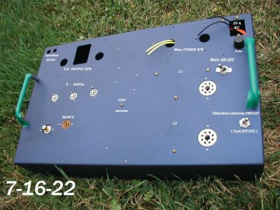

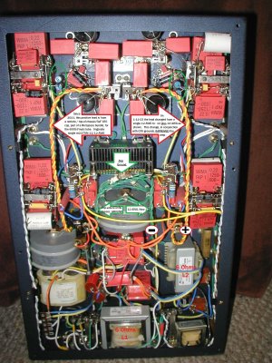

7-16-22 ............ Photo UPDATE................................

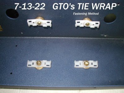

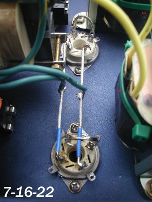

ABOVE : I typically avoid use of plastic "tie wraps" - around wiring and capacitors. In the case of three inch diameter GTO bypass caps however,, an exception is made. Notice how the cap is pre-positioned AWAY from direct contact with the chassis' bottom and side steel surfaces. This lessens magnetic chassis - fields and also extreme heat from chassis-heat-sunk power resistors. This planned positioning lengthens the life of film capacitors, by keeping them cooler.
Jeff

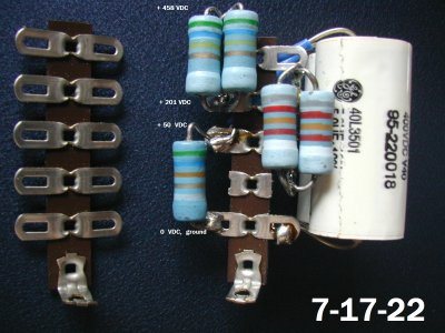

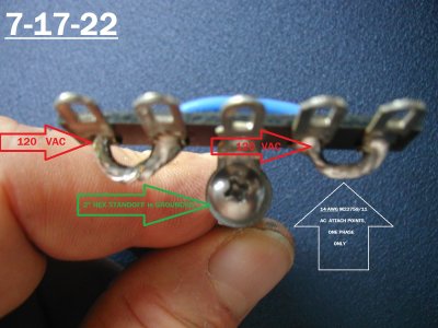

7-17-22.......................Dual FILAMENT BIASING STRING............
This is a dual-voltage resistive divider string, powered from the 458 VDC main B+ at C2, to ground. It applies two differing VDC potentials, to two differing center tapped Filament Transformers.
One transformer energizes the 6005 Filaments. It is raised above ground to about 201 VDC, at the 6005 filament transformer's center tap. The 201 VDC potential is needed in a DC amp, when the cathode is over 220 VDC above ground, so as not to exceed the 6005's suggested Heater-to-Cathode maximum voltage differential rating.of 90 VDC.
A second "tap" on this single resistive divider string places the second separate Filament Transformer ( for the Input/Driver 6E6P-E tube ) about 50 VDC above ground. This 50 VDC of Input/Driver tube Filament Biasing often makes for a SLIGHT and minor sonic improvement on a top-notch system.
..............................................................................Filament BIASING String, Dual.JPG................................................................................
+++++++++++++++++ ( 458 VDC divided by 377K Ohms total is 1.21 mA. to ground ) +++++++++++++++++
Today, I made both Resistive Voltage Divider strings, one for each monaural amplifier.

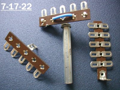

I also fashioned from a Keystone #817 terminal strip, an AC attachment terminal strip, that will allow me to attach an amp's multiple power transformers to either phase of the 120 VAC power feed. This will allow for an unambiguous and safer-to-execute process, when optimizing Internal AC Polarities by ear. Power wiring and phase selection will not be crowded or difficult to access.
Here is what the new circuits looks like, a 6-32 single bolt to install, and 4 hook up wires. ( B+. Ground, +201 VDC, and +50 VDC ).
Some other Keystone Terminals , handy for DIYing, point - to - point :
Jeff

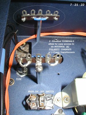

07 - 21 - 2022 .......... Started Soldering in Parts.........

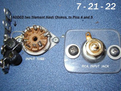

Below, installed hash chokes for the Driver tube's 6.3 VAC filament activation. Cleans up the feed.

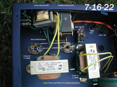

Below, RAISED both the 120 VAC main power attachment points, used for all three Power Transformers. Employed 2.5 inch long HEX standoffs, internally threaded.
This provides very EASY " in your face " ACCESS........... to optimize Internal AC PHASE Polarities better.

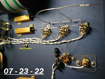

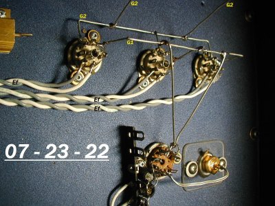

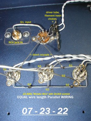

07 - 23 - 22............................. EQUAL length Wire Build Detail ........
Avoid " dog - legging " in S.E. builds, etc, when possible, employ EQUAL wire lengths .
FINALS stage , three 6005 tubes wired in parallel. 19 AWG " Wonder Wire " used.
G1 and G2 circuit wiring details photographed. Unique .
ANODE and CATHODE triple EQUAL wiring not yet ready to execute. Not shown.

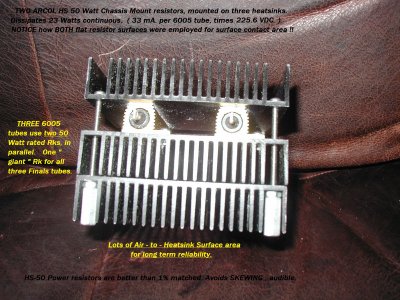

The desired 1% tolerance Cathode power resistors, used for the three 6005 tubes, are not arriving until 08-26-22 . 5% tolerance resistors simply will not do in that circuit location.

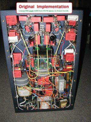

Internal Amplifier Wiring Improvements on 1-12-2023
In 2021 I introduced on HFV a stereo 6005 SE DC amplifier build.
For 2022-23, I am doing a " triple " paralleled SE amplifier design, which I intend to be an all-out monoblock pair.
I recently took my personal 2021 Stereo single 6005 per channel amplifier, and paralleled both channels externally, to HEAR and get a taste of what that it does, with two 6005s as a double. ( Nice !! )
Two days ago, I got the idea to re-wire some long ( 13 inch ) 12 AWG leads I had in my 2021 stereo 6005 amp, and this post documents that.
It took me all day to do the change.
My reference TEST music is Gilbert and Sullivan Highlights, on CD, with the Rochester NY Orchestra. Human voice mostly. From the first two notes, I KNEW this was a nice improvement. On the first cut when the large background CHORUS entered, and sang their part ( hard to reproduce ) I instantly reacted by getting goosebumps on both my arms when listening.
On two other occasions on the CD , I yelled, literally at the top of my lungs " YES YES YES " and another time I loudly yelled " Go, Go , Go". So, I suppose I liked the re-wire of that one cap in each channel.
I took the time to photograph before and after, and denote it to any who have an interest. It is hilarious to me, the best sounding amps in THIS world are NOT ever made by EEs and pHDs particularly, but by JUST a few people world-wide, who LISTEN and build, and have a passion for it all. Never forget that !!
1-12-2023 :
