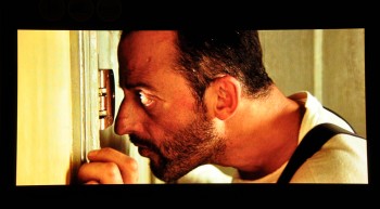

Took these pics few months ago, my plasma is not even calibrated properly, the colors don't look washed out at all.

yes,that plasma is in my listening room and it is mostly dim lit, that pic does not do justice to what i really see,i see an image which is two times better than what is shown in that pic. i also have two more 50" plasma(one in my living room and one in my native place) both are in normal home lighting conditions, they look the same and some times better while watching certain type of movies.
