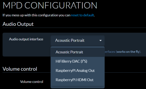

First I checked MDP settings, the output shows Acoustic Portrait. To be noted, that though Swara streamer has its own DAC that hats on the RPI, I am bypassing the Swara DAC and using Thyaga DAC, hence the USB connects from streamer to Thyaga DAC

You have 3 dacs on this device
1. inbuilt dac. This is disabled
2. hifiberry dac with the id sndrpihifiberry (must be a board connected on the RPI4). This is enabled
3. A dac with the id Portrait. This is disabled.
MPD audio outputs status: (mpc outputs)
Output 1 (Acoustic Portrait) is disabled
Output 2 (bcm2835 ALSA_1) is disabled
Output 3 (snd_rpi_hifiberry_dac) is enabled
Output 4 (bcm2835 ALSA_2) is disabled

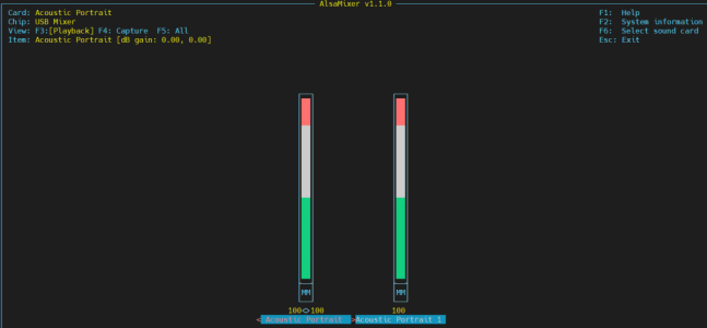

Go to the shell prompt and type the following command
alsamixer -c 2
After that you will get a screen. You can use the right and left arrow keys to select the controls. And you can use the up arrow key to increase volume and down arrow keys to decrease volume. This should fix the volume values.
But you also have to enable the Dac. For that use cantata, MALP client or MPD control kind and search for 'Output' in the menu items. In the menu item you will be able to enable the Acoustic portrait DAC.

For alsamixer -c 2 I see the following screen.
Why do I see two Acoustic Portrait?
Should I bring down the vertical bars to green level?

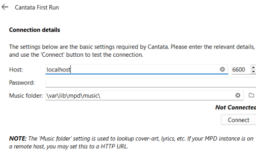

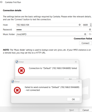

I installed Cantata on Windows 11 in my laptop, but stuck at the below configuration. Should I use runeaudio.local and port 22 here with default password of runeaudio as "rune" and leave music folder default as shown below?
No. Leave it as it is.
Instead of localhost, put the IP address of your rasperry PI3 or runeaudio.local. But remember runaudio.local starts working late after boot when avahi daemon starts running. MPD port is always 6600.
Music folder from your debug.txt shared earlier is /mnt/MPD.
Do not put \mnt\MPD. Windows uses \ instead of /

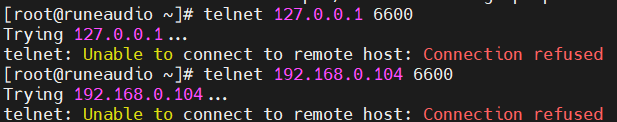

On running mpc enable Portrait I see the Connection refused error
Is mpd running?
ps -ef | grep mpd
will tell you if mpd is running.

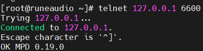

The command will check if mpd is running on port 6600
You can use the following to check
telnet 127.0.0.1 6600. e.g. on my raspberry pi
MusicPI:(pi) /home/pi >telnet 127.0.0.1 6600
Trying 127.0.0.1...
Connected to 127.0.0.1.
Escape character is '^]'.
OK MPD 0.24.0
.quit
Connection closed by foreign host.
if you see the above output then you can run the command below. NOTE You will probably see the line OK MPD 0.19 because runeaudio has installed an ancient version of MPD. This is the reason I don't use rune, volumio, etc. I just use the official raspberry PI OS. But we can make it work on the older versions installed by rune.
MPD_HOST=127.0.0.1 mpc enable Portrait
OK, will use the IP. In my case its 192.168.0.104
Noted.
I tried till this point, but Test connection does not work. I used "rune" (without quotes) as password

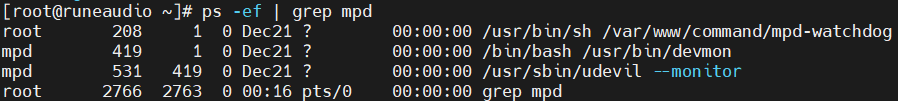

Is mpd running?
ps -ef | grep mpd
I see following output
mpd is not running. I'm not sure how runeadio has implemented mpd startup. Run the following command
systemctl start mpd.service
and after that do ps. e.g. on my raspberry pi, this is the output. The first line /usr/bin/mpd --systemd is the mpd process running. Only if mpd is running will you hear music. So your first problem is that mpd is not running. Second problem is Portrait dac is not enabled. Let me know what happens when you run the systemctl command

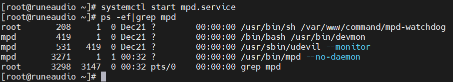

Noted, lets check if the first problem is solved. Here's what I get
This is good. Now mpd is running
Now if you run the command
mpc enable Portrait
It should work. Also cantata should be able to connect

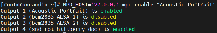

MDP services started, Can telnet, Enabled Acoustic Portrait, still hear no music ... on adding songs to queue and clicking play it does not play, neither does Cantata connects, tried ip and also runeaudio.local.
