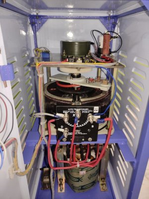

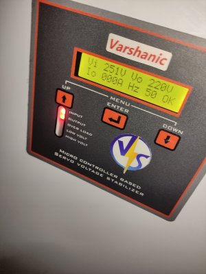

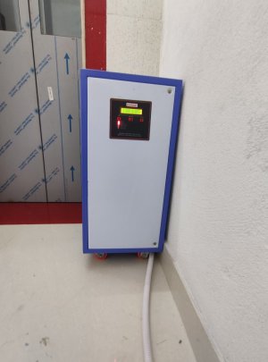

i bought this 10kva for 22k in 2021, from varshanic chennai, with MOV added for surge protection. custom built case size as per my requirement. upto 300v input

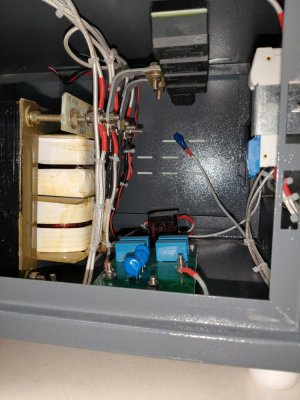

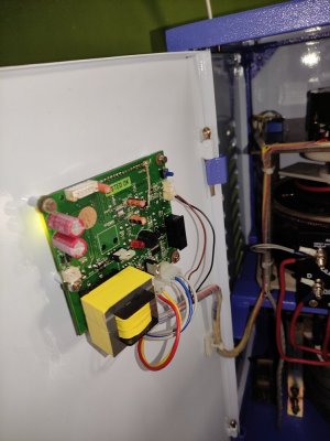

Filters and MOV's

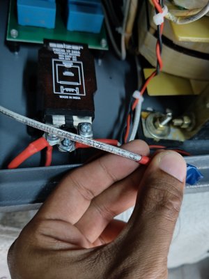

uninyvin cables used inside - current rating max 43A
Installer came to install the very next day of delivery. good service and he's like they have improved the design and now failure rate is pretty less. as per him most installations are in petrol bunks and they imbalance it (3 phase stabilizers) causing the igbts to fail, harsh conditions. cabinet design is also new, easy to access panels. fan will run only after 60-70 degrees heatsink temperature. no noise.

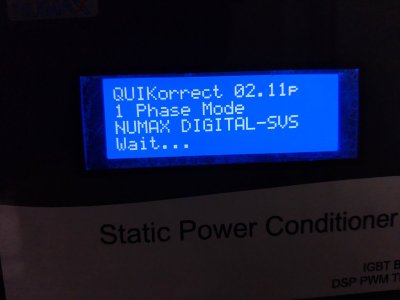

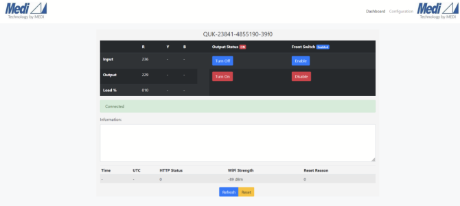

i have the option to view the display over wifi and data logging, inputV, outputV, load% and any fault conditions. can remotely turn on/off the output

Filters and MOV's

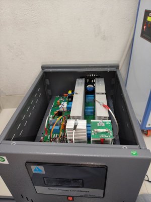

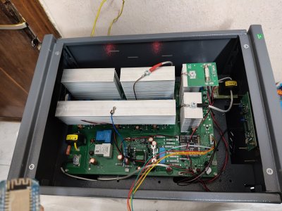

View attachment 84951View attachment 84952View attachment 84953View attachment 84954
View attachment 84955View attachment 84956
Well constructed and neat. Nice to see some quality product.
Our forum member who bought nkb technocrats 5kw if they could open the unit and share pics, can see if the cost they charge is justified with difference in quality...igbt need to be checked if same or different..
How can you access it over WiFi? I bought 5kv unit from them.
Is there anyway to turn off display as well?
Many manufacturers didn't still start the server hosting for customers as they find it additional expense. You may try contact the manufacturer, they will give additional esp8266 chip connected to the display port and unplug the display lcd. Web data upload feature might not be available with them, but it is supported fully. They might have only local web access.
Yes you can simply unplug the display, a 4 wired connector.
Can you open the unit and share some pics? I want to see why they priced it so high than numax..igbt, transformer rating, filters, mov,

I didn't get the wifi adapter from numax, i had built mine as i had built wifi communication from quikorrect dsp<->esp8266 during development with the original parent company(Medi, kerala). Let me know how much numax is charging for the wifi adapter.
I have a concern that the LEDs for 2 igbts are flickering and dull. Also I see some faint flickering in the led lights in my home when I observe closely which isn't present on direct grid. I'm afraid if this investment is a good one or it is giving out bad output waveform

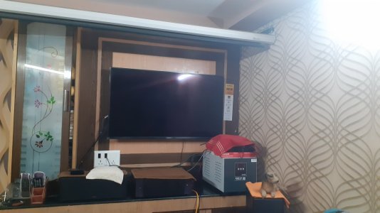

I am using a 5KVA static stabilizer from NKB Technocrats, for the past one year. It works just fine, low noise and no issues so far. I have an entire home theatre system connected to it. The owner of the company is also very helpful and will listen to your requirement before recommending a solution. Online reviews seem to be good for this company.

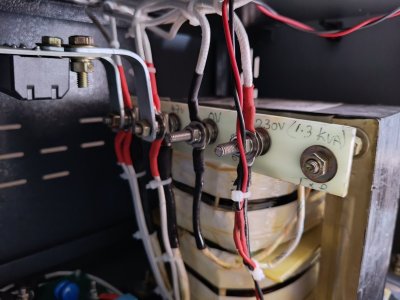

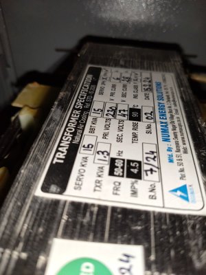

cost would be copper winding transformer, a 2 pole mcb, and maybe additional EMI/RF filters, or bypass switch...there was no test report..
basically this unit has few MOV and capacitors to filter out the harmonics produced by the unit itself.
and its quite possible to easily over-rate these devices as the max kva can be set by the setup menu fairly easily. the designed transformer seems to be of 1.3kva which translates to 6.5kva max load. this technology takes in a transformer of 1/5 of total capacity. and they rated this as 7.5 and menu setting is 8kva...it will work at the cost of component damage if it exceeds design capacity of the igbt and transformer..
