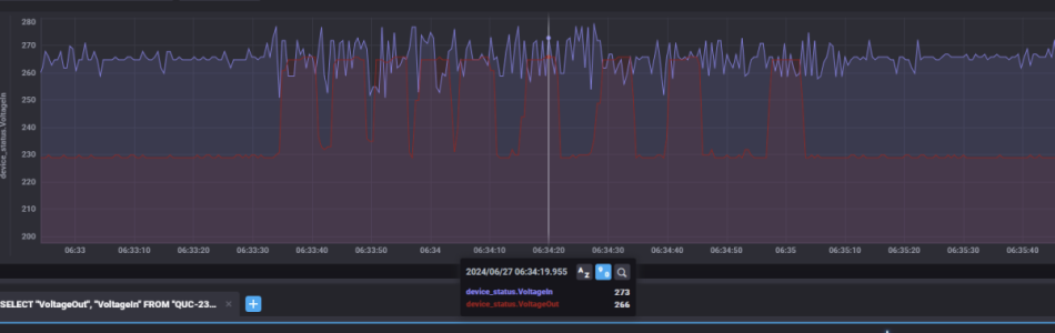

Power analyser will do the harmonics testing job for you. Or maybe you can ask numax to check it out at your place to support their theory. They may be having the tools to analyse the incoming power. This maybe is the best way to isolate the root cause of the issue you have faced. It is highly unlikely to have harmonic distortion to such an extent that it disturbes the stabilizer's functionality.
yes they have the device and have checked at sites where this is happening. they have tried to fix and diagnose but they are unable to. either their manufacturing / component selection is at fault, or the design is having an issue tolerating these harmonics, infact the design is a simple one to say, with the processing done by dsp
they have even tried to stimulate these worst harmonics with big generators, etc with additional filters and which they managed to run for few days after enhancements only to find it going back to the same issue after few days.
Yes they do have. Anyhow I'll be returning the unit.

got the new unit from numax, need to monitor. doesn't look like they added any new filters or anything. no emi/rf added

so far the new device is fine. no idea why the old one had issues, time will tell. maybe after some time it will repeat
This is so unprofessional from numax. Didn't incorporate any additions or changes even after involvement of their managing partner and his commitment to you.
