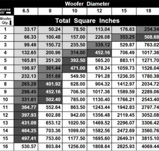

Air has to be moved.
See this chart. Most floor standers have multiple smaller size woofers. For a floor stander to move same air as a Linton would need at least 3 of 6.5" woofers, for the same as Heresy, 4 of them!! The footprint would reduce apparently with slimmer floor standers but depth, height?
Interesting chart, Subbu, but I’m not sure if I’m reading it correctly.
Doesn’t it show that two 6.5” drivers are slightly bigger than a single 8” one? (Please see the boxes I’ve marked in the pic below)
If that’s the case, the Proac’s two woofers should be larger than the Linton’s single one, right? (The Linton has three drivers: 1” tweeter, 5” midrange and 8” woofer)
Btw, I presume the wider baffle also plays a role by increasing sensitivity.

My bad, I got a bit confused. I thought Linton had 10" woofer. I was reading about KLF 5.
When I went for Heresy even two 8" were not matching the 12".
