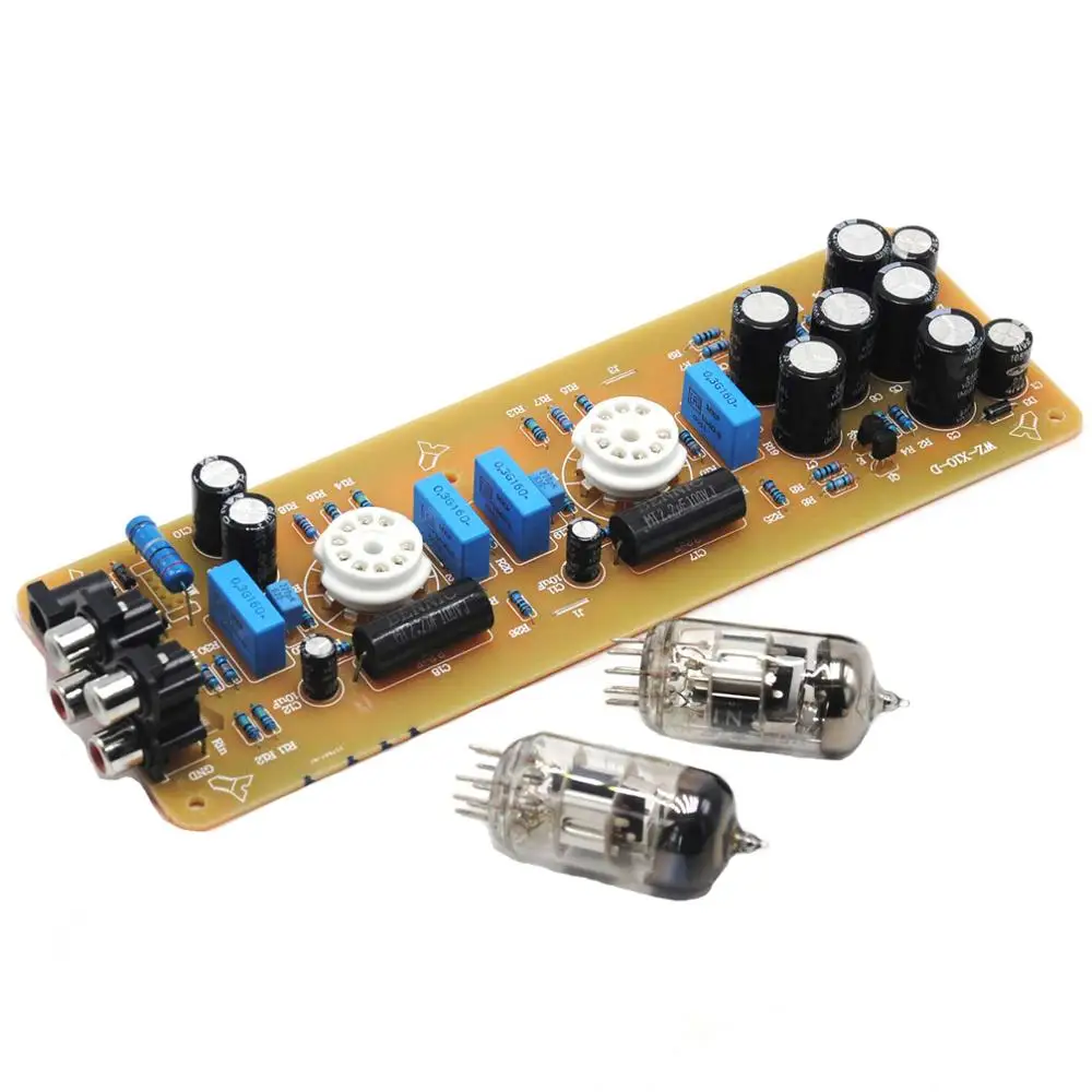

Try this. This is a tube buffer I diyed based on various tweaks and diyaudio forum discussions. It offers near unity gain. With almost no noise. It adds pleasant sonics to any source. The difference is subtle,yet very musical. Vocals and midrange is where it shines. It definitely widens and deepens sound stage. Will post a image of the diyed buffer later,when I am at home. Now, a quick diagram of the circuit.
Note 1. PS is based on triple voltage multiplier ( similar to Chinese 6j1 circuit. The current limiter two transistor filter is not mentioned in the circuit,but it's implemented)
Note 2: filament supplied by 12 volt, and two 6J1 are in series. Filament voltage Must be bypassed with minimum 6800 MFD cap for absolutely noise free/ hum free operation..1576244695043765602894.jpg
