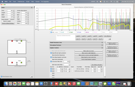

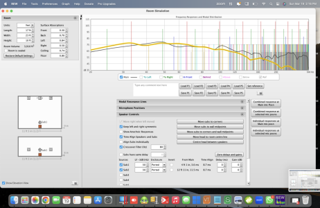

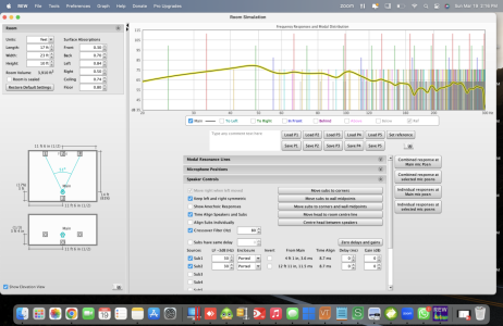

Hi please find the attached screen shots. If you keep your two subs at the front and back of the room in the center of the 24 foot width wall that should be ideal. You will achieve a very smooth bass response at the MLP.

How are the surface absorptions levels so high in these graphs?
When we say Surface absorptions many things can be considered. For example you don't need to treat 70 percent of your back wall with treatment. Even your seating can be considered an absorber. This is just an approximation that we need to add a larger percentage of the rear wall absorptive then reflective. These graphs won't tell you which particular sections of the wall need treatment and what treatment is required. For that we would need to create an acoustic analysis and treatment design. What is important to read from the graphs is the advantage of putting two subs and if placed correctly and with the correct room treatment what kind of frequency response is achievable.
