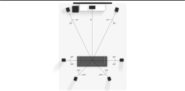

I have just to learn about the HT setup. My home is construction is going on and planning to enable speaker points in concrete itself for 7.1 HT Setup.
viewing distance is 12 ft to TV
Total room length is 15 ft and width is 12 ft
I need help with below 2 points
1. Front floor level what should be height for all speaker placement ( from floor level 5ft or 7 ft)
2. ⁠placement/angle of 7 speaker from the seating position
Thanks in advance.
The tweeter of the speakers should be around ear height, which is around 3.5-4 feeet. Try to make a isoceles triangle between your MLP and L and R speakers. Placement of sub deoends on room acoustics and not easy to comment on, so, place multiple outlets for subwoofer (RCA) at various places in the room where it will be possible to place a sub.
Preferably add 4 Atmos in-ceiling speakers in the false ceiling.
Look at the Dolby guidelines for more details.
Best of luck!!

As you mentioned, identified below coordinates for speaker placement for mentioned room size.
Please correct if any of the placement is wrong
Front Left Speaker (L): (-5, 0)
Front Right Speaker (R): (5, 0)
MLP: (0, 11)
Left Side Surround Speaker (LS): (-7.5, 12)
Right Side Surround Speaker (RS): (7.5, 12)
Left Rear Surround Speaker (LR): (-3.3, 15)
Right Rear Surround Speaker (RR): (3.3, 15)
