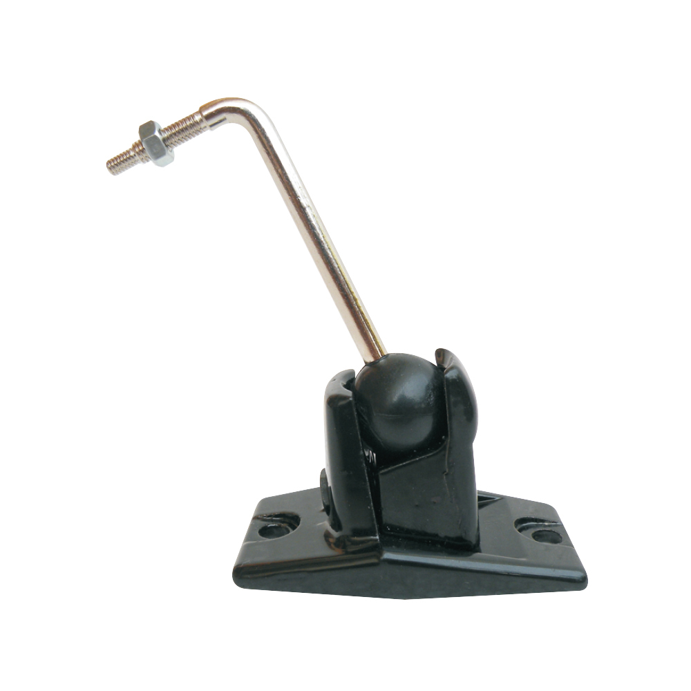

Whichever side doesn't have wall to mount the surrounds, you can consider these wall mounts..
MX 2pc Speaker Stand & Cctv Camera Stand Max Load 10 Kg Mounting Bracket -MX3306 | eBay
Also, they are affordable..
