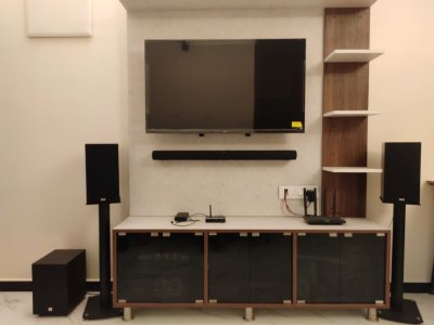

Resurrecting this thread since my audio setup is yet to be completed for my Chennai home. Now that I am in Chennai (keep shunting b/w Mumbai & Chennai every 3 months) , I was looking to get my budget system completed.
As mentioned in this thread earlier my listening distance b/w my wooden wall panel and sofa would be 6-7 feet from the picture attached.
Regarding placement of speakers, am looking at two options
- Option 1 - Place the speakers below the sound bar (above the cabinet) with IsoAcoustics Mini Puck or isolation stands subject to speaker height.
- Option 2- Buy Nexus Speaker Stands and place them on either side of the wall panel with fairly good toe-in.

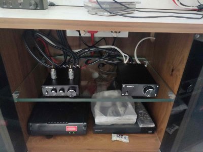

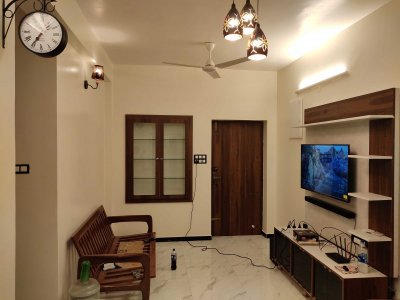

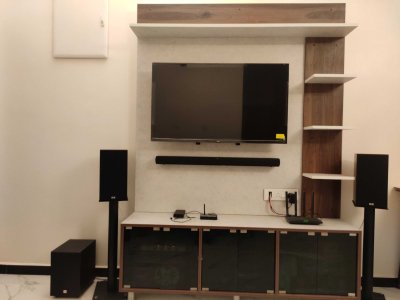

As requested posting pictures of the setup.
Power Bank is used to power the FiiO BTA30 Pro and using LDAC Bluetooth codec to play the music from my android mobile via VLC Player
Speaker Cables used are DAC OFC 14 AWG (bare connections), RCA Interconnects used are DAC ARX01A.
I was not able to use banana plugs on the AIYIMA A07 speaker terminals.
For my listening position which is 6-7 feet away, had to toe-in the speakers (walnut finish with grills) as can be seen from the setup.
Next project is tube and Op-amp rolling for both AIYIMA T3 & A07 after couple of months post enjoying this sound signature.

For Genres like Smooth Listening / Jazz / Pop / Western Classical / Blues - they sound really great and non fatiguing. For Rock / Heavy Metal, they are really bright and needs tweaking on the EQ side to have an enjoyable experience.
Thats Excellent. Yes the signature smoothens out after a few hours of running. Best way to Burn in a speaker is to hook it up to your TV Audio chain. Within 2 weeks you'll have perfectly burned in speakers. Especially with IPL every day. Easy 2-3 hours of running every day.
I would suggest you skip the Allo Digione signature. Availability is really poor. Unless you can find one in the pre used market. I recently sold my Digione Signature + Shanti setup. Moved to a Wiim Pro and I am loving it. So see if you can find something like that. A wiim pro or mini or even an ifi Zen Stream.
