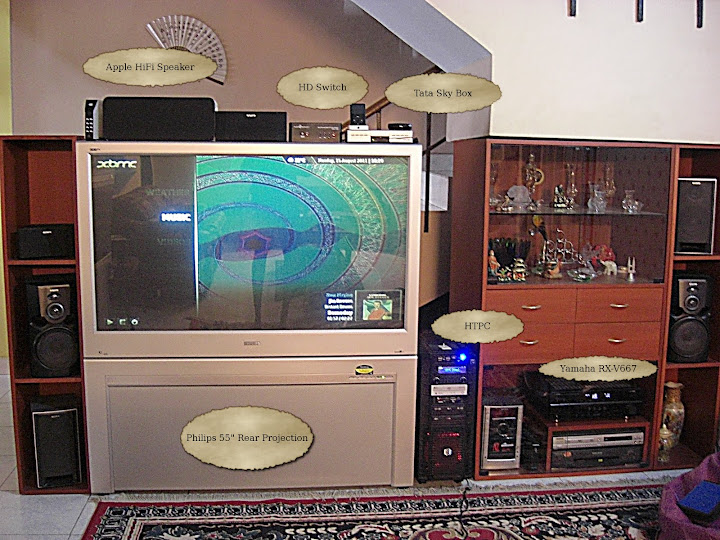

I had a 55" Philips Rear Projection HDTV purchased in Jan 2003 for 1.5L. It had 3 oil cooled guns (RGB) which was supposed to last only few thousand hours and supposed to have the so called image retention issues. It is still running strong. The only problem in these last 9 years was that I had to replace two convergence chip (STK).
The tv was huge and impossible to bring it with me when I shifted from Chennai to Pune. I gave it away as a freebie to the guy who purchased my flat and it is still running strong.
