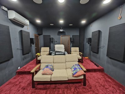

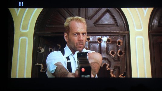

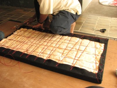

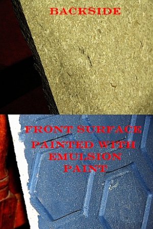

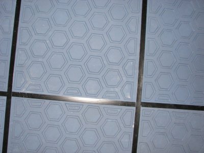

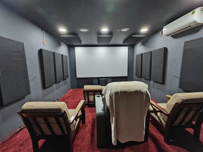

hi
i am seeing your thread for the first time and regret not having seen it earlier....i could have given some tips of my experience.
any way i will share my experience....
1. room size - you are almost near one of the golden ratios for an ideal room acoustically...Ratio B of Sepmeyer's golden room ratios for room size needing minimal acoustic treatment.
2. i used regular ceiling panels of the type used in old cinema houses. there is air gap of 9" above the ceiling panels.
3. my walls are bare, with placement of DIY acoustic panels as required. location decided by simple reflection in the mirror method.
4. concrete flooring covered with carpet underlay and then carpeted.
you do need a certain minimum expenditure to get a good acoustically ideal HT. above that , there is no limit to what can be spent. but never stray from your goal....i have seen HT installations costing a lot sounding horrible.
5. my screen is DIY 138" 16:9 size, Al. channel frame with regular flex printing polymer sheet in reverse. attached screen shot is from 720p panny.
best of luck

hi
best of luck
