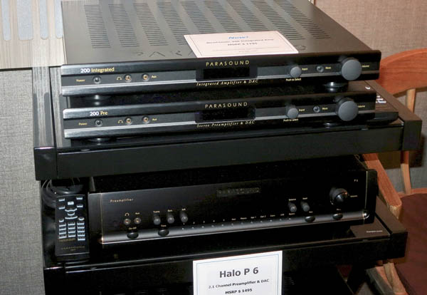

Take a look at this too (don't know whose tech they use)
Pascal Audio module is used in Parasound's latest IA.

Paragraph two praises Parasound's NC200INT driving Tekton speakers.
This unit has a Class D power amp module from Pascal Audio.
