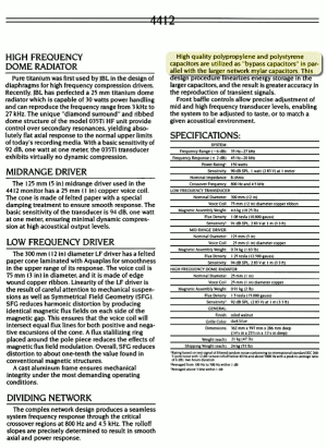

Hope this helps with the value's and wiring, as for the availability of the parts hope FM's can help.

Not from "A" model, but if I'm reading the 4412 manual correctly, there are no electrolytic caps. Not sure you need new XO parts if that's right. Perhaps try to do the easy stuff first--disconnect, clean, reconnect. Try other amp to verify speaker issue, etc first. It's easy to lose years w/o re-making connections and it can matter.
