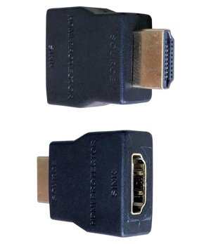

A local service center for Yamaha Audio also suggested me to use HDMI connector protector like this…👇🏼 so as to avoid HDMI Current leakage.

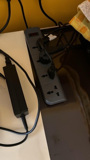

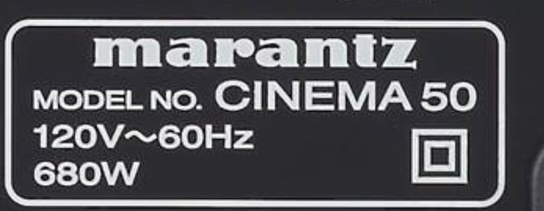

For Marantz Cinema 50, do I also need to change my main socket from present 5 Amps to 15 Amps?
The Marantz Power Plug is a standard 5 amps one. You need to ensure the Electric Outlet is good and can provide enough current for the AVR. Typically Cinema 50 would be around 650watts - 710 watts of consumption. I use a SR6014 which is 9.2 channel (Somewhat like the Cinema 50) and plugged in a dedicated surge board.
If yes then, what about my Surge protector? Can I still plug it into the 15 Amps socket & continue to plug in TV, JBL 660P & Marantz Cinema 50 into the surge protector?
Won’t a 15 Amps power wall socket blow off my Sony OLED or JBL 660P Sub b’coz 15 Amps ideally is being used for Geyser, Fridge or Microwave.
There is no actual harm in my opinion but those with more tech knowledge should chime in here. An Appliance (TV or Amp) will pull current from the socket to operate, nothing will blow unless there is extra raw power being sent to the outlet causing appliances then to fry away!
If the electric socket is in proper order there will be no current leakages to the AVR or other sensitive electronic products which can fry it.
It would be advisable to check all outlets and electric supply for the whole house to ensure there is no leakage and there is ample supply before connecting any expensive sensitive appliance. Not sure of this device if being used by any of the Forum Members

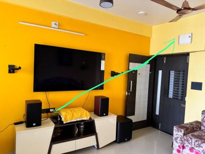

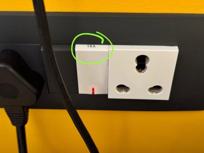

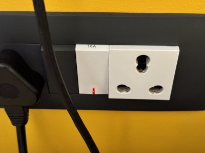

Hello All, finally got the switch board changed from 5 Amps to 16 Amps. It’s of Legrand - best brand.
The electrician said that Towers type buildings already have 1.5 Amp electric cables provided by the builder to support 15 Amps. Is that true?

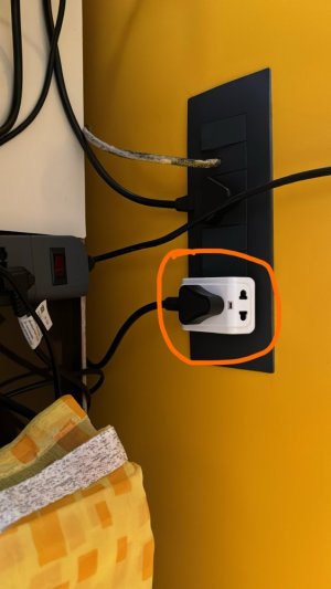

I just talked to another electrician & he said that 1.5mm thickness electric wire behind these sockets are not sufficient to handle 16 Amps socket. I need to pull in 2.5MM electric wire from ELCB in my living room either from behind the wall or from outside.
It's all confusion. He said 16 Amps socket can be fixed anywhere but, it also needs a supporting 2.5MM thick electric cables.
If I continue with 1.5MM thick electric cable on a 16 Amps Legrand Socket then, what will happen?

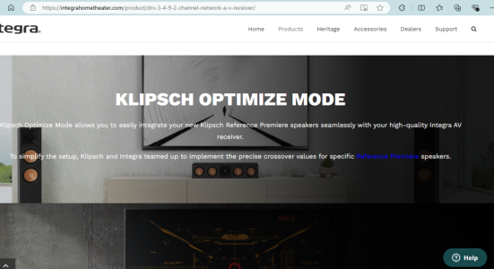

Check out the Integra DRX 3.4 - it’s 100W x 9 channels, all preouts, and most importantly has Dirac. It also comes with 18 months warranty instead of 12, and is the same price as Cinema60
Chec
Thank you. I have emailed their support team to kindly share address of their authorized Dealer / Distributor in India. I checked the website of this product: https://integrahometheater.com/product/drx-3-4-9-2-channel-network-a-v-receiver/ & noticed this Amp is primarily made for Klipsch speakers. I don't like Klipsch speakers at all as once I had auditioned them & walked out within 5 to 10 seconds as they sound so pointed like a needle, harsh sound.
They’re not made for Klipsch - they just have a mode that automatically sets crossovers if your speakers happen to be Klipsch. Integra is a very well regard brand from Japan, owned by Onkyo and now PAC, known for features and reliability
Current distributor is Cinebels ( www.cinebels.com ), I’d got my Pioneer LX-505 from them in Mumbai before they took up Integra too

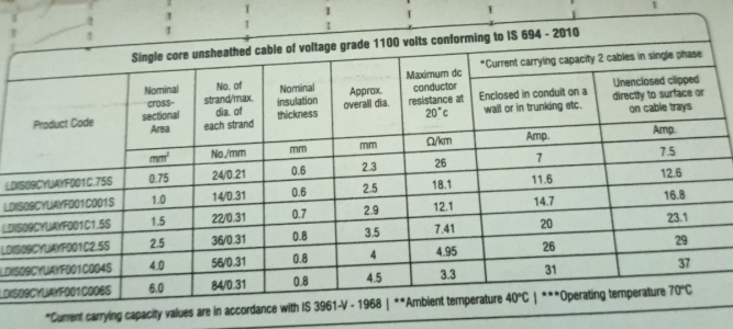

You need to address this first . Don't go by the Electricians Guess work . Why would any Builder spend more and put extra gauge wire ? . If there was a 6 amp socket , most probably he would have put a 0.75 Sq mm Wire . All wires can handle a bit more current than what they are rated for BUT only for a limited amount of time . Electricians often use this and put a lower gauge wire and tell you not to worry . Capacity of the wire will vary slightly depending on the brand / type etc.
I had my wiring done last year . So refer attachment for Polycab wires , which is what mostly they all use .
Use the wire to 80% of its actual capacity . Hence go for one gauge higher .
For 16 amps I have put 2.5 sq mm wire (3 wires - Phase , Neutral and Earth) from the socket to junction box in the house . Don't Join wires to the existing wire (some electricians do that) . IT should go from the socket to your Junction box and get connected to MCB , Neutral Bar and Earthing . Polycab.png
All said and done I am not sure which AVR will require this kind of power . When you get one , the AVR power cord will most probably have 0.75 Sq mm or 1.0 Sq mm printed on it . So in case you already have 1.5 Sq mm Wiring then don't spend on wiring . But do check first .
In case the same circuit is being used for other purposes , then put 2.5 and be safe . I have 3 amps and even if play all together they will not cross 6 amps . But I had this wiring done with future upgrades in gear in mind and also my stabilizer needs that 16 amp pin .
For 16 amps I have put 2.5 sq mm wire (3 wires - Phase , Neutral and Earth) from the socket to junction box in the house . Don't Join wires to the existing wire (some electricians do that) . IT should go from the socket to your Junction box and get connected to MCB , Neutral Bar and Earthing . View attachment 85341

if its 1.5 for sure then nothing will happen , your wire should have a capacity of handling 14 amps so that's more than sufficient for Marantz Cinema 50 .
use this to figure out ....from the color of the wire ...it seems you have a 3 phase supply at your house . But again check all this and then use the below table . Just double the current required finally and accordingly do your wiring .
2.5 Sq mm will ensure that in case there are future upgrades, additional gear etc or you get some stabiliser etc ...then you dont have to redo the wiring again and again
