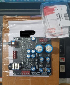

Discrete Dynamics PAM12 from Aniket in Delhi is the best-sounding preamp out of buffers and preamps I've built. Better than the DCB1 and the Salas Hotrodded DCB1 in my system to my ears. However, the Salas Hotrodded version sounds amazing in @rikhav system. So YMMV.

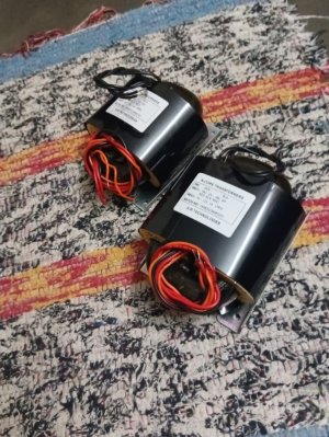

Today got Two Nos R Core from AM Technologies for DD pre and PeeCeeBee Pre(though PeeCeeBee Pre yet to be Received).
Thanks Akaudiotech View attachment 77792MANIR,
Nice job getting multiple Power Transformers, and R-Cores no less. My 2021 - developed personal - use stereo 6005 amp has four different Shilchar R-Cores, and I am delighted with the results. I wish you well.
Please remember to listen to Power Transformers AC-PHASE- hook-up-wise, both phases on music ( clip leads .........carefully ) and settle on best sounding Phase to YOUR ears on music.

A M Technologies, got no from one FM, ordered over WhatsApp. Not yet checked the performance, only Sec volts only checked and found OK. Fine finishing . Company is at your Great Mumbai. Phone No is in the label. Cel.No: 9 8 2 0 2 4 2 1 6 4 ( I think,I didn't break the Forum rules & I have no connection with them).
