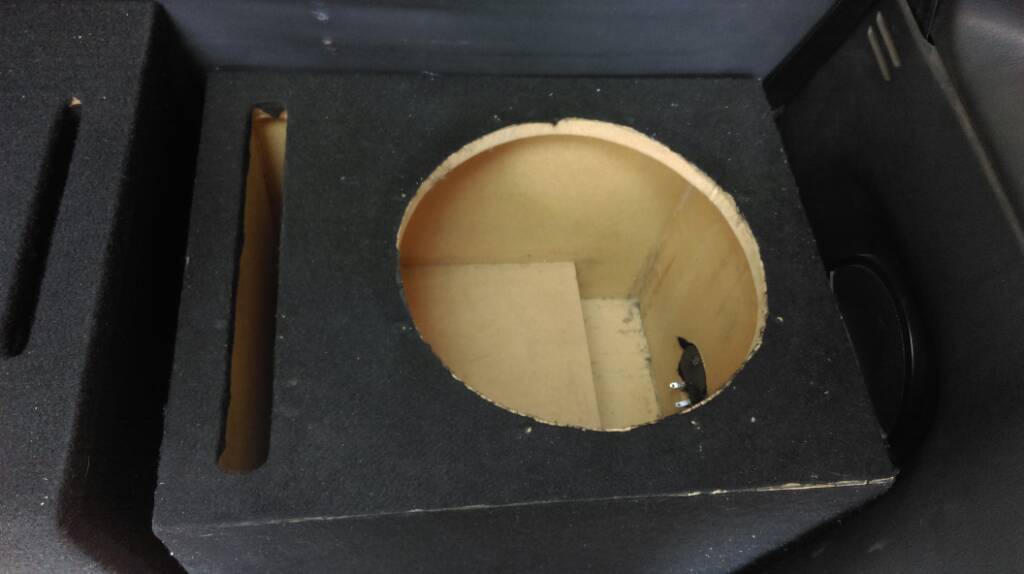

As it happens. That's exactly what i use in my car. I have the rf62 12 inch with a 1cuft sealed box. Used it with my home amp. It was cleaner but none of that low bass decay that is cool in movies. Back then my pc was just for movies. For movies, ported. Considering cheap and diy budgets. But sure the infinity was cool for rock and pop music.
