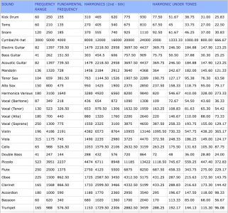

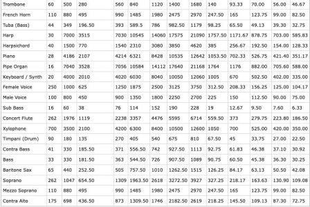

Most music doesn't go below 40 Hz, unless you're into Electronic genres. Below 40 Hz is primarily useful in an HT setup.
Frequency response of musical instruments:
You are right and hence in most Genres it may not make a difference. But again some of this is deceptive eg Eric Clapton unplugged has a drum at around 25hz ( have measured in many years back). Grandmas Hands by Livingston Tyler also has a thump at low 20s which you will not hear in most setups
And once you hear it very difficult listening to the same without it but if you are not aware of it you can still enjoy the music.
The table you have given, for each one of these look at the lowest fundamental and then the harmonic undertones which is not just 1/2 of that but also one at 1/4th .All of this summed up ( ie fundamental + undertones+overtones) together gives you the timbre of that instrument and hence what separates the sound of a Cello and double bass at say 80Hz is not just the 40 hz but also the 20 Hz .
At 50 Hz and below music is also very tactile ie the ability of pressurizing the room and hence the impact on body becomes more important as well and hence large drivers or subs moving air can make that impact.
Personally my speakers go down to 35Hz and unless I put a sub cannot feel all of this as well but for 95% of music i listen to 40hz and above is enough
