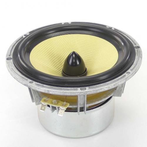

I think the Tweeter is untouched, I need driver of the speaker, the driver model no is zz11460. If you find somewhere, please let me know.
do check the crossover as well. the work done on midwoofer indicates a replacement for a burnt voice coil. that means that
1. there is a possibility of some caps get getting fried as well.
2. a burnt VC means the speaker was overdriven, possibly to clipping (unless it was a mega amp driving the bookshelves), clipped signals can damage the tweeters in an instant.
3. (does the undamaged side sound wonderful?) an overdrive on one side means means the other side was probably overdriven too, maybe not to the point of being burnt out.
overall the prognosis is not good. unless you get everything checked you may be throwing good money after bad. you have already spent 1.5 lakhs. whatever you spend on replacement of midwoofer unless you have verified everything else is fine, Chances are that you wills till be disappointed.

I have examined the mechanics, he told me that the speaker coil is not original, I have shared the Pic. Both speaker coils are different colors (locally made), and the Speaker Cone area has been dismantled. I am searching Original driver of the speaker model no zz11460. The only option is to replace the driver.
Thanks, but the driver model number is different. Is it perfect match for my speaker and will get same performance.
It won’t match if you don’t have the exact model 805s. As I googled, there are multiple 805 models-805 and 805s(improved version). Swapping the drivers from one variant to the other will not work as the crossover would be optimized for the driver. I meant you can email them and ask if you have the same model you need.
The other option is to keep this aside until you find a used 805 with some other defect and Frankenstein both the speakers. I had luck on certain things after years.

I emaild Good Vision VOF with your shared link, they reply didn't have the driver of this speaker. Thanks youer support.

I had emailed the company regarding availment the Driver, but didn't get any answer from them.

Honestly going by re-coning service charges it comes to 175$ for one driver (before customs), add cost and repair for crossover and one is looking at around 300 or so USD for one speaker. After this the left and right speakers may not sound the same. For the amount of money sunk into this speaker I would suggest it is better to ask the seller to take this back and even settle for lesser refund. Pouring money into this project IMO is ill advised.

Opting for repairing this speaker does not sound to be a good solution and even won't make sense commercially.

I let the speaker to repir it to Mr Vivek from Kolkta. He is trying to fix it but problem is arramge to find original voice coil & Spider.
