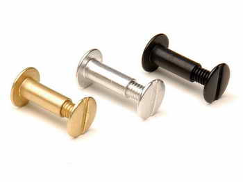

Copy pasting a pic link of something like this which will help
They are easily available in various lengths as they are used in Pic albums and agreement collating. You can glue the bottom part to plinth. Also see if you can put in thin rubber washer.

That seems like a good idea. I'm assuming one would get those screws in a stationary shop? As far as screws in wood plugs goes I'm thinking as long as the bedplate is flat it should not cause issues...

Stevie regular hardware stores may have them. If they dont have it request some photostudio guys to procure them.
