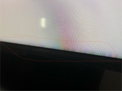

Hi all,
Just got a U7k today in 85 inches. TV looks great but in the bottom right there looks to be some bands of color visible when viewing grey/white content. It’s only really noticeable if you’re looking for it. Is there anything I can do about this? If not is it worth returning over?

Hi all,
Tyler
Bad! I suggest exchange! Check grey Uniformity of other 85inch folks here!
Thanks! I did check the grey uniformity and other than that spot it seems to be pretty good unfortunately. Will definitely return soon. Should I roll the dice again or maybe try an 85 inch TCL Q7 or a 75 QM8 or X90L?

Maybe some sort of manufacturing defect or panel damage? It’s visible on most colors to some extent but mostly on grey
