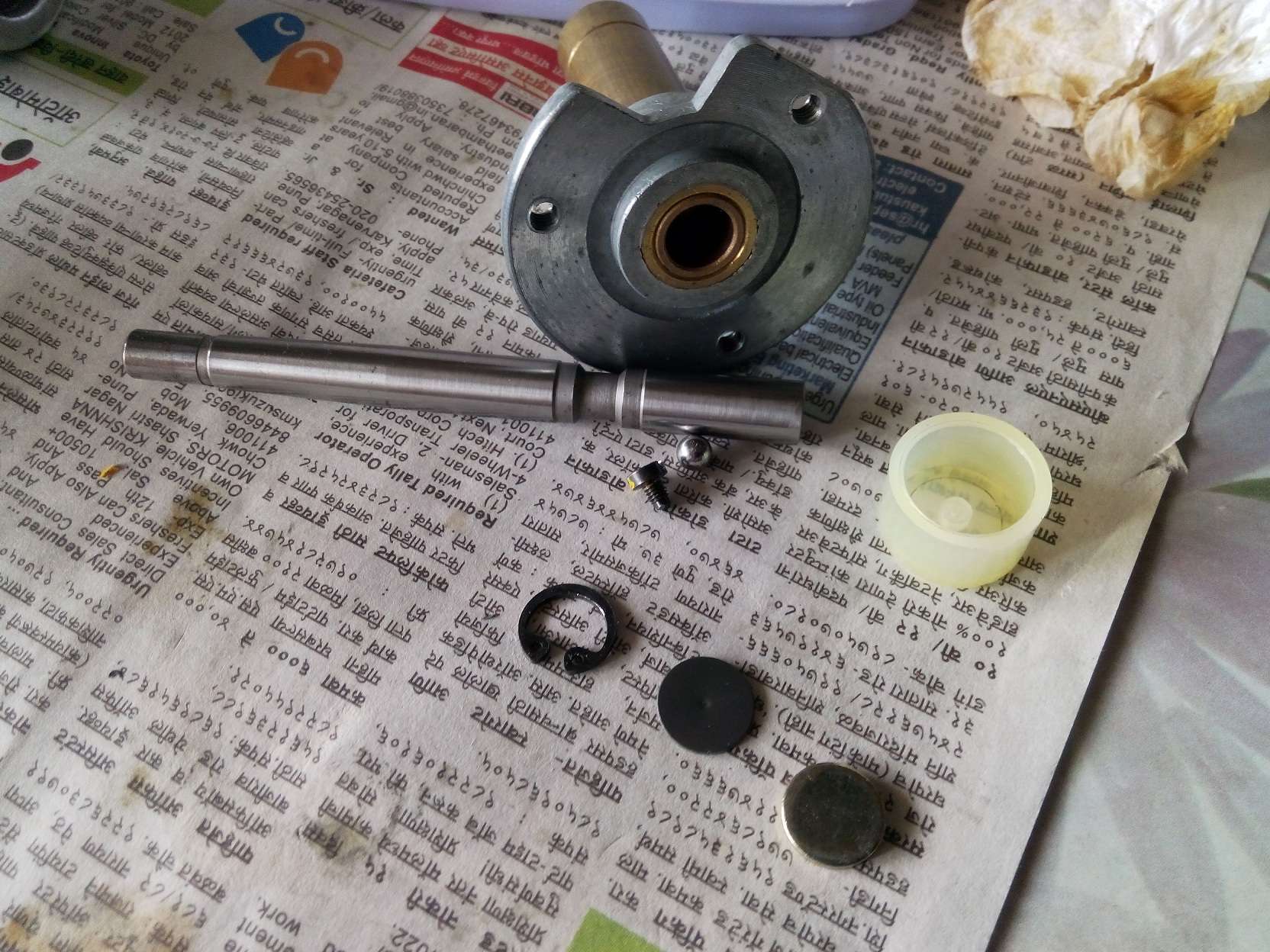

I have done it twice for 2 Lencos, it takes 2 hrs with slowest speed and at most care.
Here you go..
I removed motor and bearing before starting work. See the 40 year old grease into it.
Before starting work.
Look at my tools to remove C-clip from motor as well as bearing.
Cleaned all parts bushing etc. Please pay attention to tension screw (in yellow circle) which is half hollow and spring loaded with cylindrical insert. (red circle)
Tension adjustment after fitting is like this - tight the screw fully but loosely. Then unwind half-or one turn. You are done.
Parts near to yellow circle are at front of armature and parts near the rectangular pressure plate are towards end of armature.( behind wire connections)
Main bearing cleaned with IPO and wiped.
Everything in place.

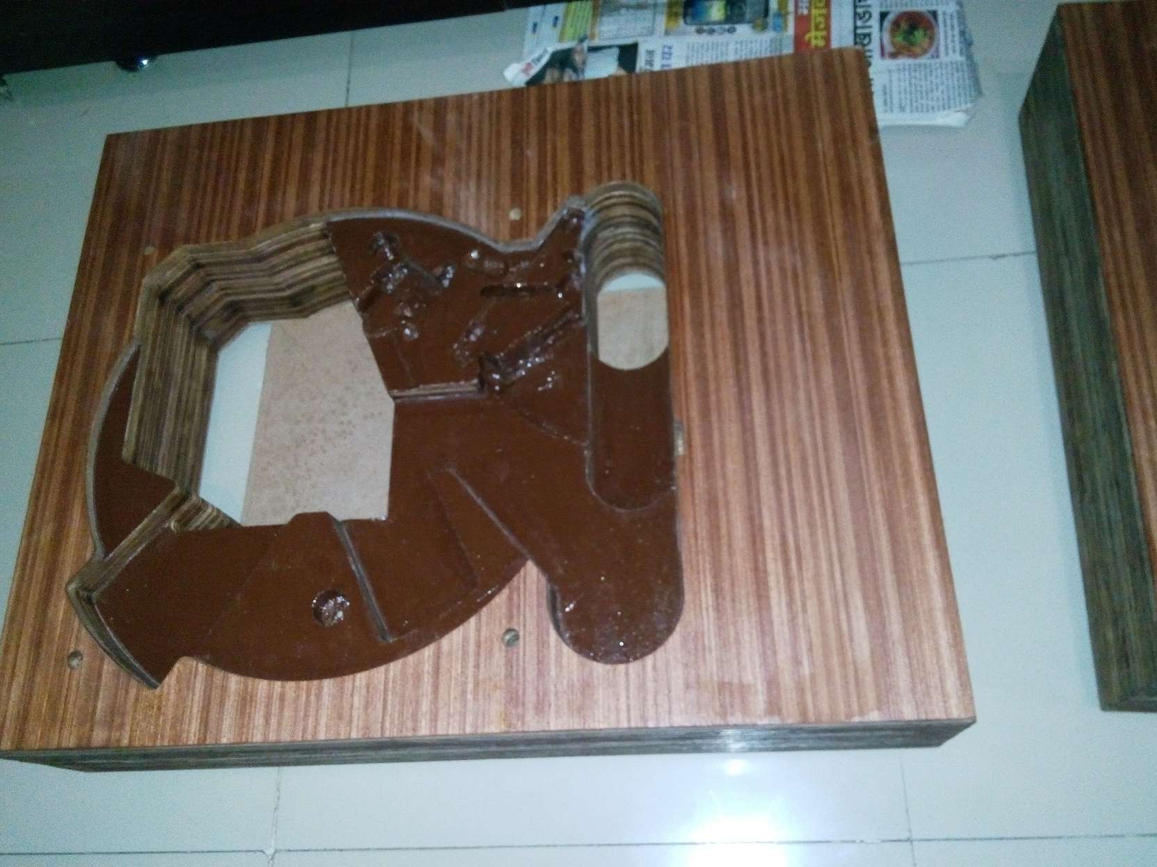

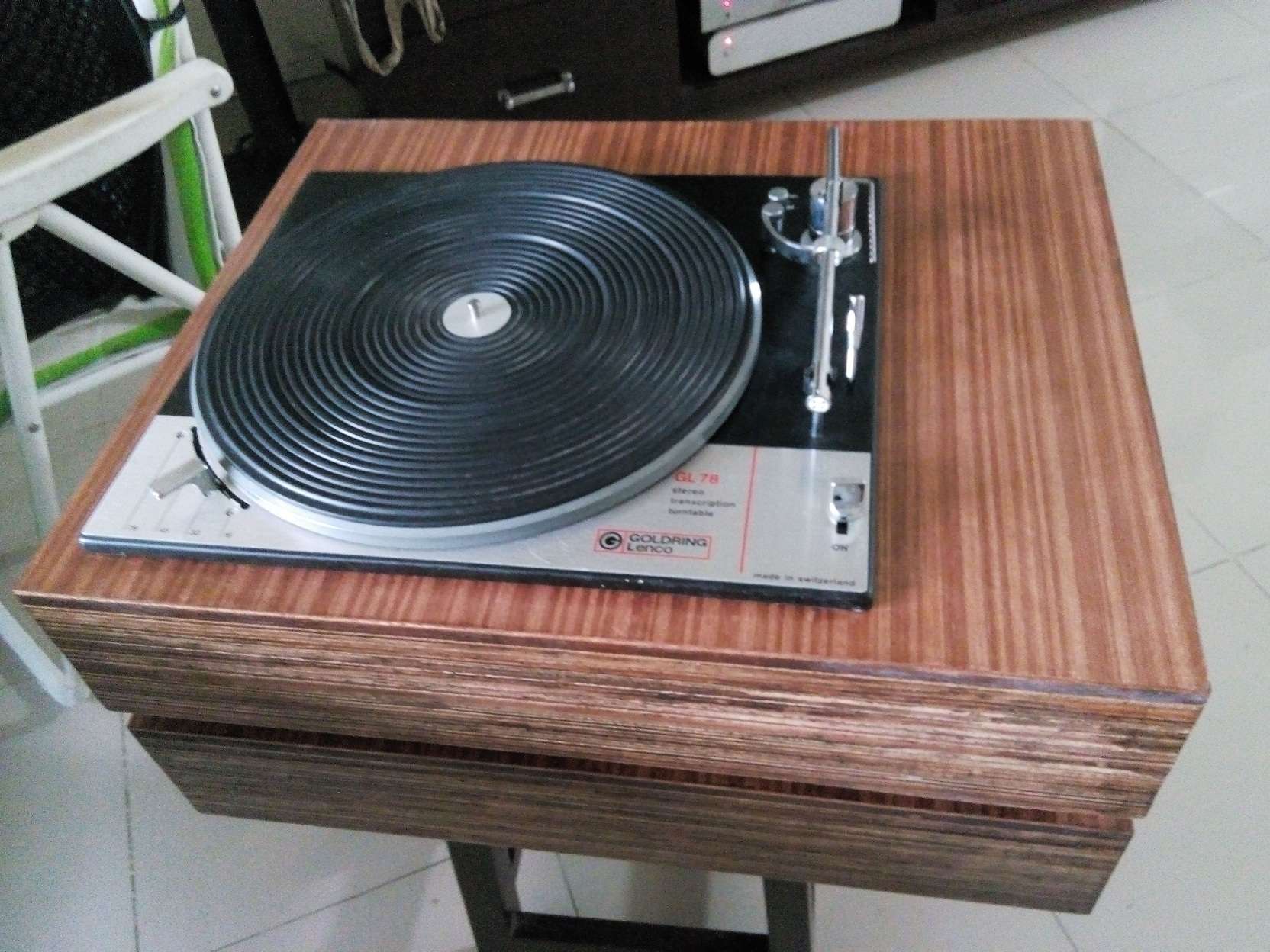

My two plinths -
Top view of plinth. multiple coats of primer and oil paint color at inside and bottom side. Polished all other sides everywhere. Smooth enough to retain natural finish.
Finally rested :D These are two plinth, not single :).

Excellent Om,
pics don't justice.I have seen those unfinished Gurjan ply plinths in person,when Raghu visited my place. Please take some nice pics without flash :D
Sachin
Excellent Om,
Sachin
True Sachin! They are very heavy >12Kg each and photos with camera flash don't justify. I need to take better picture in natural light.

Very elaborate pictures. A Lenco motor will sound much smoother if serviced and the secret of Lenco's success in my opinion is the motor's silence. It's a cool operator.
Om,
Thank you Sir,
Yes motor is extremely silent. In fact I was trying to hear motor noise in silent tracks with full volume. Surface noise was audible along with faint 50Hz mains pickup by phono wires. Nothing below 90% volume.
And how much lithium based grease it needs? Not more than size of toothpaste filling toothbrush. :) approx size of 2 peanuts.
I was at Omji's place recently and he was meticulously working on these plinths with great care even though he was having severe back ache due to working on this project! The finished product looks cool but the amount of back breaking (literally!) work simply has to yield nothing short of something special!
Respect!
