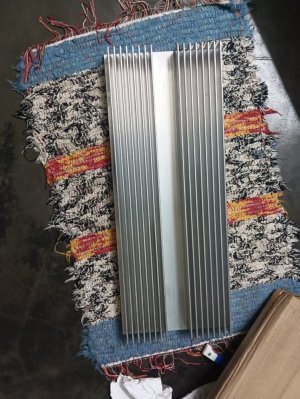

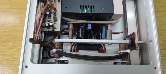

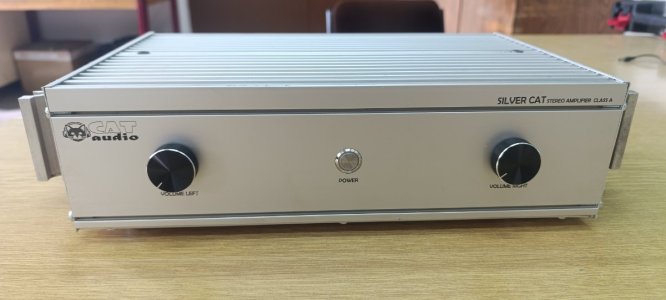

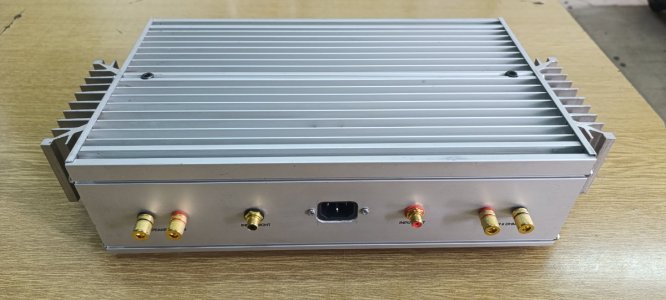

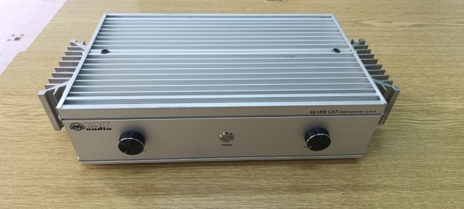

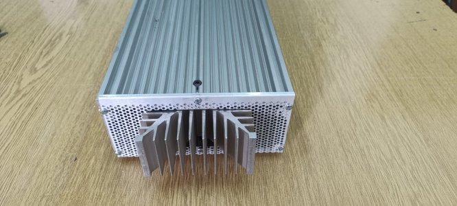

Today received Heatsink for my JLH project,(500mm)
Thanks for the FMs for guiding to Perfect Metals, Bangaluru
Very slow in progress.

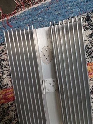

what is the optimum spacing between 2N3055 placed horizontally in Heatsink , such in JLH
While proper biasing at 1.2A for 8 ohm speakers is important for good performance, it can also lead to heat generation in JLH amplifiers, especially if using horizontal heat sinks. This might cause some to run a cooler amplifier by under-biasing it, but that can negatively impact sound quality and stability.
Horizontal heat sinks: These can be less effective at dissipating heat compared to vertical heat sinks due to reduced airflow.
Proper bias current: 1.2A for 8 ohm speakers is a recommended bias current for JLH amplifiers for optimal performance.
Heat generation: JLH amplifiers can get hot, especially with horizontal heat sinks and proper bias current.
Under-biasing: Running a JLH amplifier with lower than recommended bias current may lead to cooler operation but can also cause distortion and instability.
