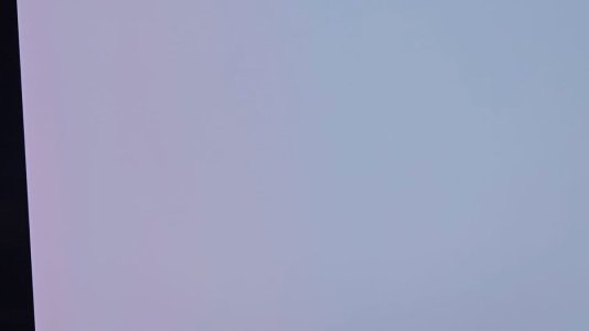

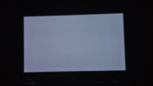

Hello,
Unfortunately i see pink tint/bleed on my LG C2 65inch tv on the left side. Other people please comment if anyone has issue and how it was corrected? Does it effect viewing? also over the time will it messup more? Should i ask for tv replace as its 5 months old and its under insurance and warrenty for 3 years.? I am big LG fan did i miss buying sonys or samsungs?
TIA

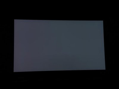

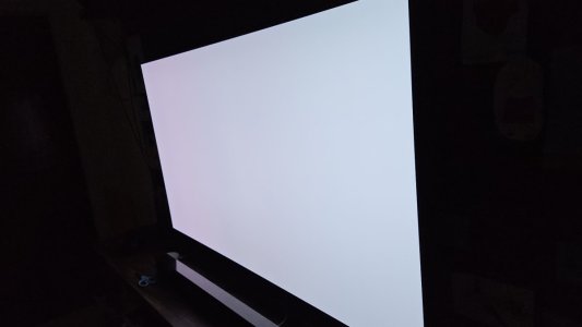

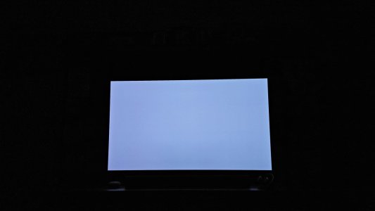

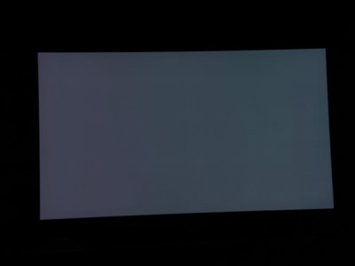

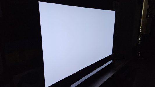

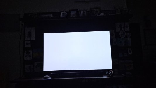

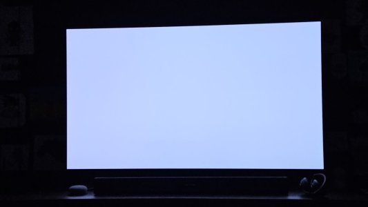

Adding few more images. Please suggest next steps?

Initialy in technician said angle issue. I asked why this was not their during installation? why after 4 month?. Why its seen when sat on center too.? Then he accepted the probelm and checking more with technical team.
Adding angle photos. See from right corner full pink on left.20230803_131148.jpg20230803_131148.jpg
See from left corner no pink at all in right.
Engineer accepted the problem.. I want tv replacement as its 4 months old.. they are doing panel replace.. please suggest?
10,000+ hrs (2 years) clocked on my Evo panel and no burn in/ discoloration, despite using it primarily as a PC monitor with plenty of static elements😁
Its a pink taint diagonally observed by OP. They replaced the panel. But first they were in denial nothing big happened.
