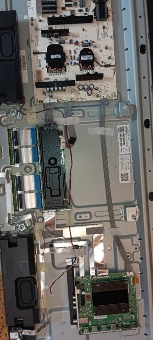

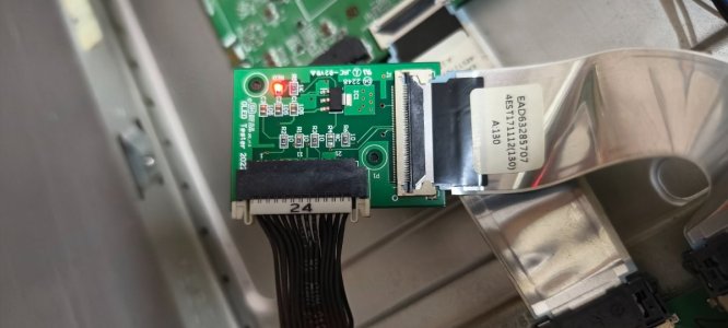

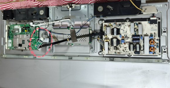

Some pics I took while he hooked up the test device. He removed a wire from the motherboard and then hooked this device up. When the TV was powered up this device blinked a red indicator and then he checked the panel and said it's dead.

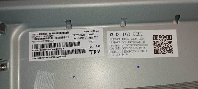

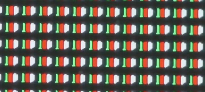

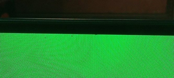

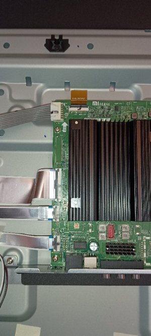

I Bought same Xiaomi OLED Vision from Amazon 5 times and return all one by one . The TV is great for an Oled Tv for 50 thousand(during GIF sale) only issue is each panel have dead Pixels. The Panel used in this tv is exact same as in LG CX 55 I confirm it by pixel structure and TCON board model if I can attach LG CX and above board to it will also support 120hz and VRR. Even Xiaomi don't have replacement panel for it one of these TV Xiaomi picked by and refund to my Bank. The UI is so smooth as no other TV in this range have quad A73 MT9615 processor with 3 GB Ram. LG do have some issues with their OLED panel they don't last even when not used all had OLED screen time 0 hrs when I installed them all have protected sheet on Panel which I loved to peel every single time.

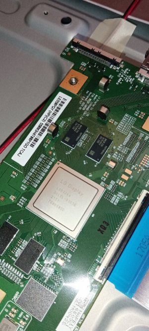

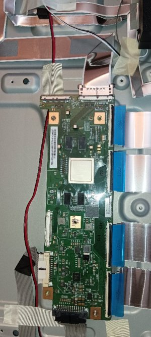

1. If you can get TCON board you can check is panel is faulty or board is faulty.
2. Not worth it for B7 model.
3. This could be TCON problem or OLED PCB issue as well but you can only find TCON PCB replacement, other board comes with panel itself.
