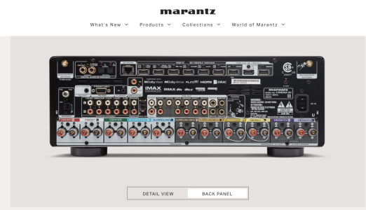

Hi Guys! I received Cinema 50 a few days back but have not installed it yet. After receiving it, I realized that out of 2 pairs of Atmos, only 1 pair is powered and the other pair is pre-out only. I already have 4 ceiling speakers. Someone suggested I connect both left ceiling speakers to the Left Height out on the Amp and similarly right ceiling speakers to the Right Height out. Has anyone made this kind of connection? Please advise.
Don't do that. Get a small 3 or 2 channel amp, like Emotiva BasX A2 or A3. Use it to power the front LR or LCR(depending on what you get).
This is the right and expensive way of using all channels.
The other option is to get a cheap class-d amp like Aiyima and use it to power the extra height channels.
Get a cheap class D amp like the Fosi V3/Aiyima A07 max and you're good to go. Adding better amplification for the height channels is going to make very little difference, if any, unless (i) you intend to listen to music solely through your atmos speakers i.e. without front LR, center and surrounds playing, and (ii) you've got money burning a hole into your pocket.
Are you sure its pre-out? Because "Height 2" terminals are speaker terminals as per your image
I think I will go with the cheap way for now. later I will upgrade to a power amp for LCR. That's future planning. Thanks.
Yeah. I checked Amazon. It is not very expensive. does anyone have first-hand experience with these amps? thanks.
Yeah. I am sure. I checked the manual. only 9 are powered speakers. A local dealer confirmed the "Height2" is not powered out. they are pre-out only.
