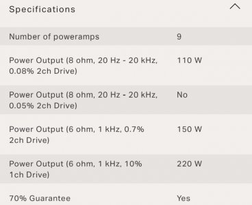

The onboard power amp is the power amplifier built in on the AVR. These usually claim exaggerated power ratings, usually with 2 channels driven. I rarely see an honest spec that says the power rated with all channels driven. The manufacturers specify the other way round - at one channel driven! I have not yet used an AVR to drive only one channel- maybe there’s a use case, I do not know. See how power ratings vary as shown in the pic. Which means, the AVR (if it doesn’t have enough power) is going to “struggle” to keep up with demanding action sequences that employ most, if not all channels, especially when you are going loud. Using a dedicated power amp, say, for L and R, gives better performance since the dedicated power amp (such as a Crown amp, not a skimpy one) would have a enough headroom (reserve power) when needed, before distortion sets in. But, if your room is small, a mid-level AVR should be sufficient enough. As I had noted earlier, bigger AV electronics need bigger rooms to shine. You could go ahead and get one, but you would be underutilising them.
