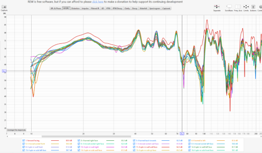

i ran room eq wizard today. my pb 2000 pro went till 12hz when i placed in front right and facing right side. but as usual have null in 70 to hz what to do?
Did you measure along with your speakers also playing? If yes, the red line which has the most output seems to have the best response at 90hz and above.
