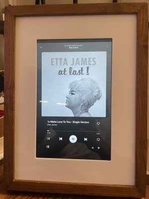

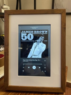

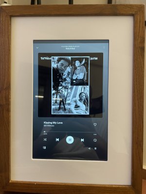

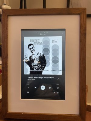

Not sure if this counts as AV Gear! But a purely aesthetic addition to my setup. Something I have been working towards getting right for a while!
The idea was to get something that can display Spotify/TIDAL - NOW PLAYING screen at all times. I have been working on various prototypes and finally found someone who could put my ideas into practice & execute with perfection :)
The device is a cheapish 10 inch tablet, this turned out to be the optimum size for the Spotify Now Playing screen as it was readable from anywhere in the room. Also the ratio of the album art vs the info below turned out to be the best on a 10 inch tablet.
I have signed into this tablet with a separate ID I created (as this tablet will never be locked). The tablet is set to always on. Spotify now playing screen is Pinned. The tablet has been put on e-reader mode (So it is Black & White - 😍). All apps (except some system apps) are either disabled or uninstalled - so only SPOTIFY is working for now, will add tidal soon.

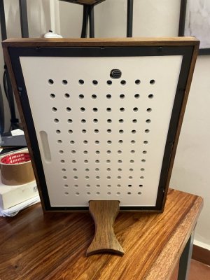

The frame is teak wood - the back is routed MDF. The tablet can be put in both Landscape or Portrait mode. For my usage - portrait it is!

Absolutely gorgeous 😍 ...Love it :)

Great job. Like the ports behind too.

It is being used as a controller - primarily for Wiim :) . For most of the day it is sitting next to me on my desk and I just use this as a controller for Spotify.
I had originally planned to create this as a "pretty looking thing" with a bit of functionality.
However since it has come in to the picture (no pun intended); I end up shuffling it about a lot between my desk as a controller, my office shelf as a "picture frame for Spotify" or our coffee area where the - "occupants of the house or visiting friends" generally gather to take breaks from our routines. It sits next to the coffee machine & anyone can use it to play music either in my office or the HT setup. The "lounge/coffee area" works as a pathway between the HT/Drawing room and my office. So it just works.

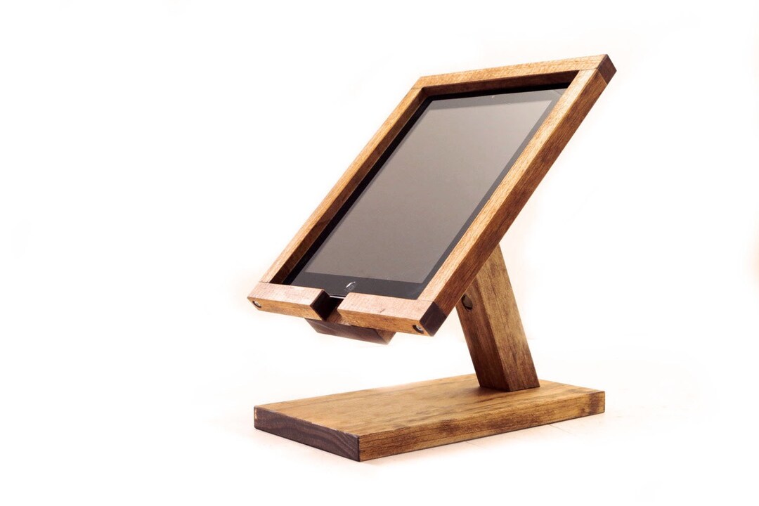

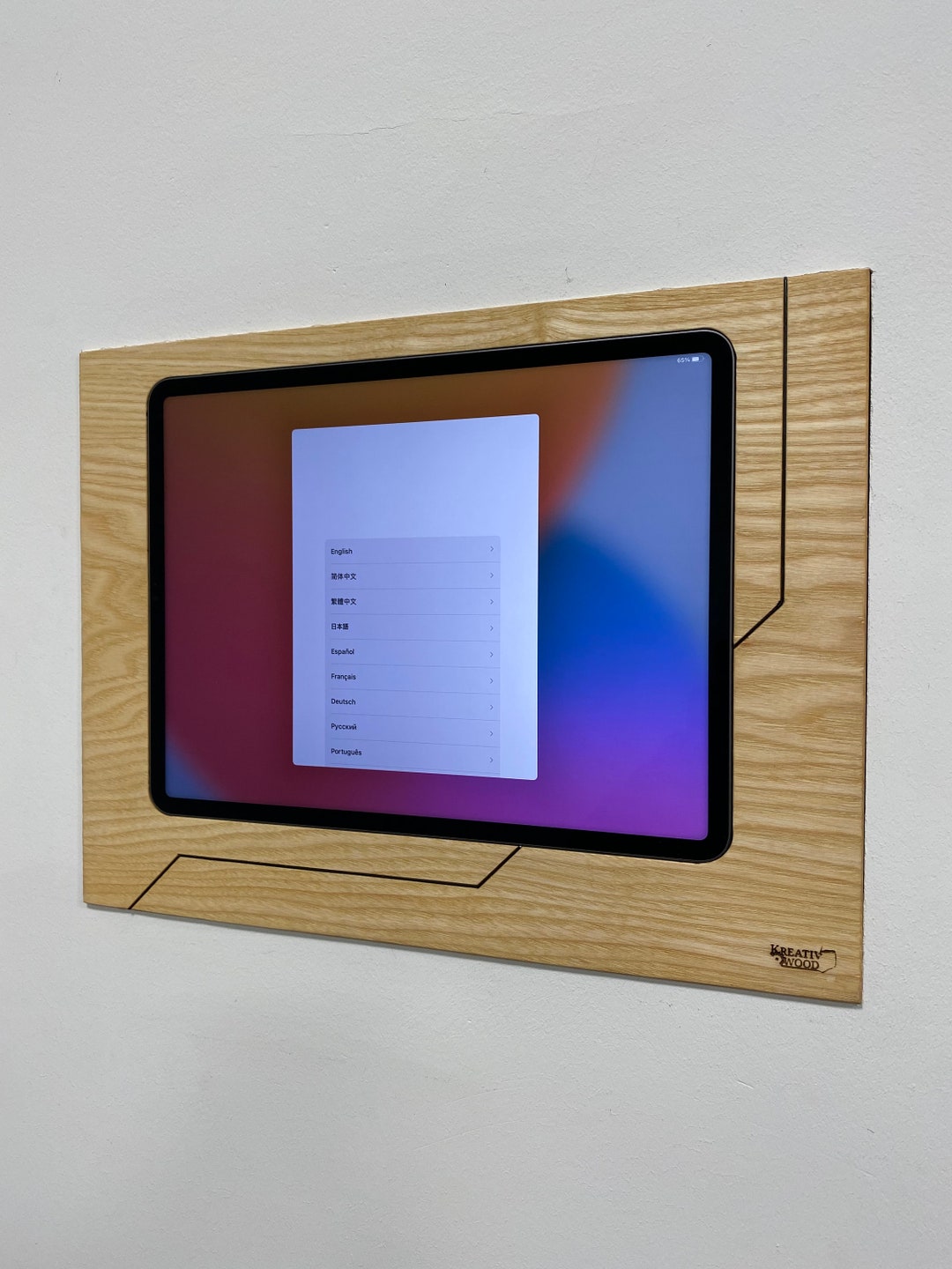

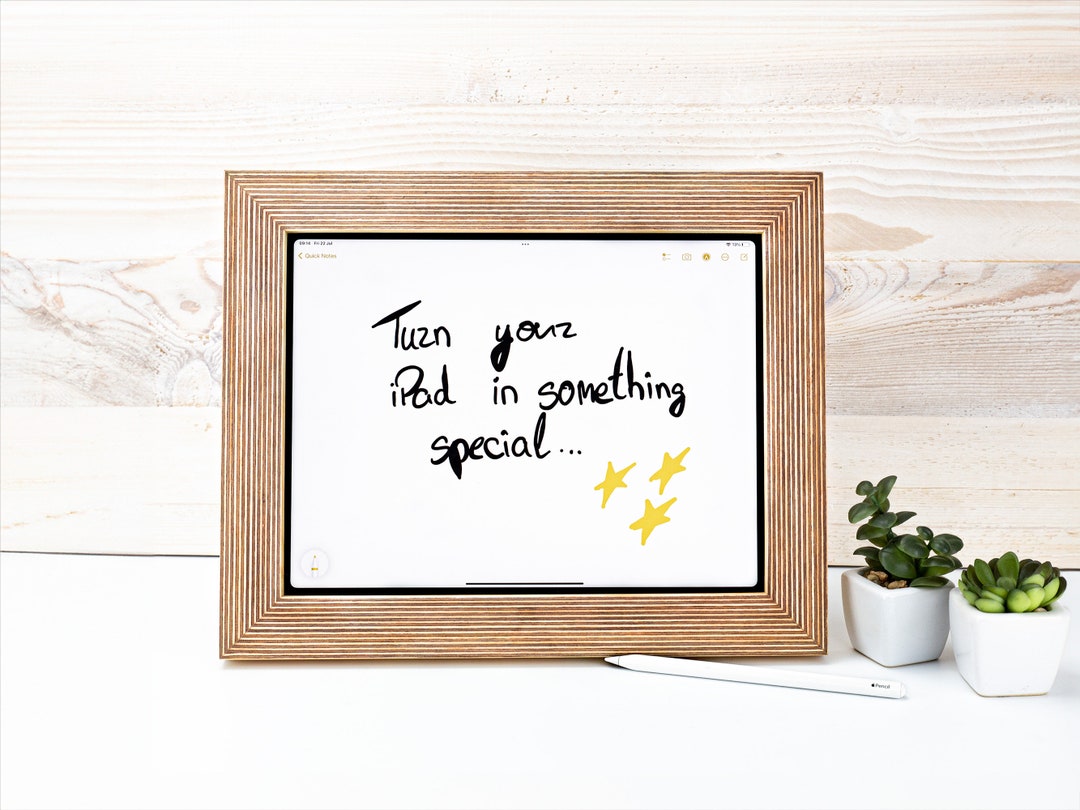

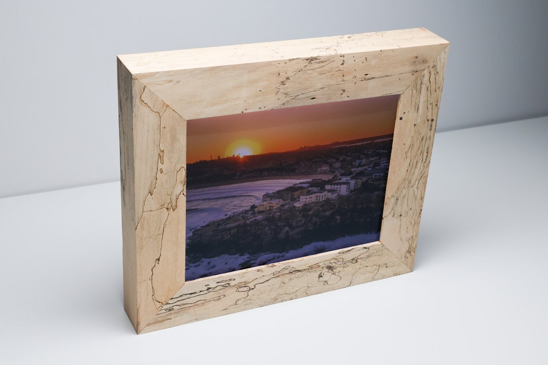

A few references if anyone is interested :)
With the talented bunch of DIYers here on this forum - a lot of these designs can be made here and maybe even improved upon :) A commercial opportunity waiting :)

Ok what you saw in my case is -
1 - An Honor Pad X8 tablet - with all the programs either force stopped or uninstalled.
2 - The tablet is put in ebook mode - hence B&W.
3 - The programs are either Wiim App, or Spotify App or Tidal App.
4 - App pinning is switched on so the thing stays put.
Spotify is amazing in the sense that if you leave the now playing screen on - the system just keeps it there till you lets say play a new song :)
