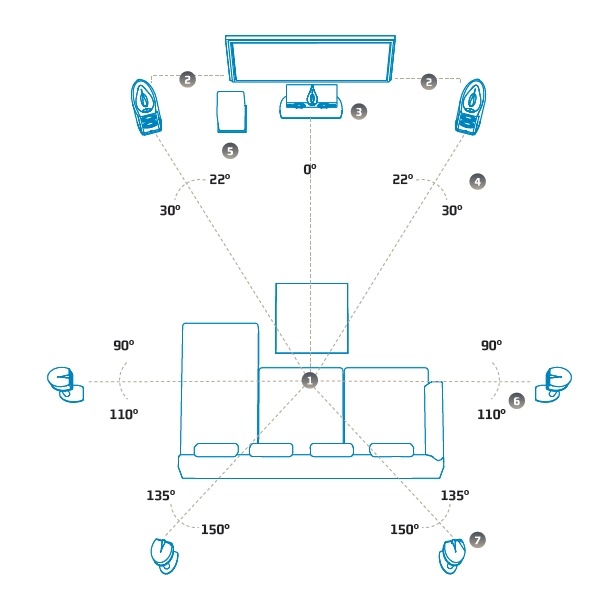

Considering what audyseey does with time delay, is it necessary to have the surround back or Front heights as per the desired location ? for e.g., even if we keep the surround back near to listening position (in same row as side surround), won't the audyssey will do the necessary settings to keep the setup as it should be without having to move the speakers as per dolby/thx/dts recommendation ?
Front heights location is straight forward...
But for fronts, surrounds, surround backs there is no fixed location & they can deviate lil around 20 - 30 degrees.. Surround back is tricky when you don't have the back wall...
Yes Audyssey should set the delay for the surround back channels, but if the speakers are not optimally placed, you may not be able to get the desired effects...
I remember reading somewhere in this forum where someone tried the Front heights on top of the listening position (like atmos) and got favourable results.
I am wondering if I place the BS on top of the rack position (not in ceiling) just behind the listening position and try DPLIIz, what will be the effects are ! I admit i won't get the atmos effect, but will it have a desirable effect if not worse.
may be need to test it !!
Am not very sure if that would work... But if juz going to place it on rack, then you should try it....
I hooked up front heights on top of the rack behind the listening position. Watched Mission Impossible (Part 2). It was decoded only in Dolby Digital and the movie watching experience was good overall. I did not find the front heights at the back of the listening position a distraction and I had a overall immersive home cinema watching experience. I used DSX mode for the watch and I will continue to use this mode for upcoming bluray's as well.
Overall the experiment didn't go horrible and I feel I can continue with this setup for few months for now.
Great... Hooking up the front heights in the right place will yield you even better results...
