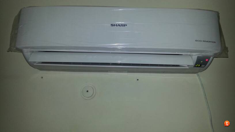

After a marathon 4 hour install I am loving it.. super quiet.. running 25-26 with 60% eco mode with fan on full blast...

I have mine installed on the side wall - din't want cold air blowing directly on to my face. But I still feel uncomfortable - when A/C cuts in and the cold air hits you. Tried adjusting the louvers in a fixed position - din't help.
Now I am thinking of shifting the Indoor unit mounting to the wall near the feet.
Will it help or am I different:lol:
indoor unit should not be directly over the head else you'd get up with a choked nose and headache however near the feet is not a good option..
put it on either side if that's no possible.. then this particular model has horizontal flip of the air panel which will throw air to the ceiling..ideally to the fan and let the fan do the job of distribution. which will not be uncomfortable.

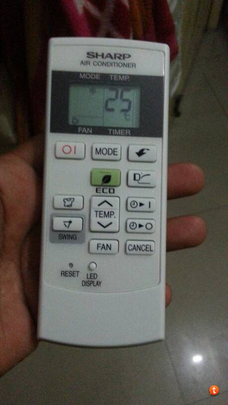

and yes the remote left me with much more to be desired. my 3 y old LG ac has night glow buttons for on/off and thermostat control at least.
no 4 way swing .. not deal killer but then fancy of having it :D
does not show room temperature like lg remote : have moved my desk clock with temp sensor to bedroom.
fan speed is lil abrupt : 1-2-3 is low and then 4 is like paddling the gas on a Ferrari..

I told you, the remote is a brick :)
the remote is indeed a brick.. compared to my other lg remote which looks like a Korean cutie pie this definitely looks like a old fart from japan..

the problem was copper pipe was 3 meters and to run it through the wall then over the concrete shade and getting down 2-3 feet below my windows level was not working out. i was hell bent over getting the outer unit just outside my window where the top of the outer unit in clearance with my window panel by max 1 inch when opened.
i did the same with LG as well. this makes sure i can see most of the area of the outer unit and access easy cleaning. once a while i take my local 18000rpm blower and blow the hell out of the dust of outer units and then clean fins with a mug of water.:ohyeah:
back to the issue : to make all the adjustments in 3 meters itself we had to drill a hole 3-4 inch width from the concrete shade and then bending the pipe at multiple points while hanging in air..
but it did work out. though i also gave a helping hand for a cpl of hours and had to resort in shower for next 30 minutes :)
