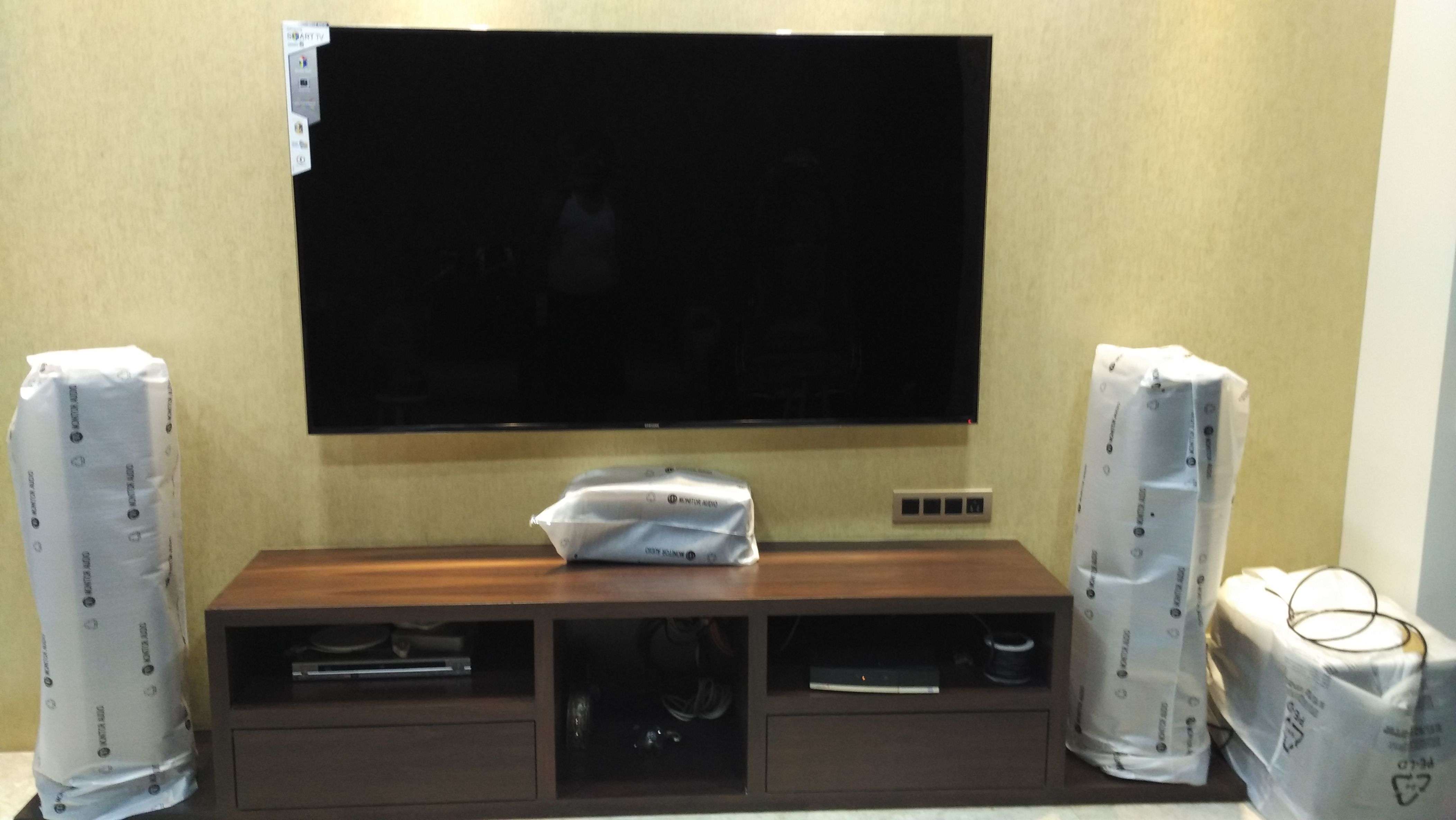

:yahoo::yahoo: Finallyy the setup is sealed signed n delivered :ohyeah:
Jus waiting for the Maxine 110v transformer. Had placed order on 20th should receive it any moment and v r ready to Rock :clapping:
