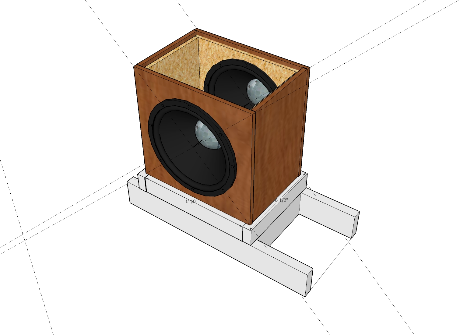

Having tried the subs suspended from ceiling, and the response it offers if mounted at ideal locations, i would like to try 4 subs (2 drivers in each location & opposing each other) with 18mm plywood as false ceiling + use the false ceiling as a sealed enclosure for subs + to hold height speakers.. I was anyways planning to get false ceiling done..
Would i have a remote chance of improving the dip if i were to use 4 subs (2 drivers in each location & opposing each other)? like below image.. My room also would look tidy with subs hidden inside false ceiling.. Should i (or) shouldn't i do it?..
If you mount all the four subs in the ceiling, you will not be able to get rid of any height mode. Think of this scenario as trying to get rid of width mode by putting all the subs in one corner.
Having said that, it’s hard to get rid of height mode just by sub positioning. Main reason is we do not have much flexibility in mounting subs height wise. Unless you think of mounting on front wall or back wall.
In your current situation - If it were me, i would have tried to see if cross over at 60 and measuring combined front + sub response gives a better output. You should be able to measure it and make an informed decision.
As for mounting subs in false ceiling, it’s my pipe dream if I ever return to india. Having tried infinite baffle sub, I prefer that in comparison to other sub implementation. However, you have two major challenges. Make sure there is no flexing of false ceiling (sturdy enough) and there is no leakage of air. The false ceiling should be braced enough and sealed to give you best output.
As for opposed drivers with out of phase to each other - it’s a very common thing in IB. It helps in cancelling the dual opposed mechanical forces and vibrations. It’s actually preferred to mount subs that way. I have it the same way in my IB arrangement.

Made some progress with wooden structure on ceiling as planned earlier.. Had to chase the carpenter to get this done..
Located a scrap wood dealer near home..
The scrap wood is sold Rs 38/Kg.. So for my entire ceiling of 14ft x 11ft area and planned partitions, had to pick approx 120Kgs of wood to build the frame..
Approx cost of raw material - Rs 4,500 + Rs 300 to ship it to my location.. Totally Rs 4,800/-..
Explained the carpenter with details on spacing from ceiling and two columns of wooden structure to hold 6 sealed speakers.. (Dual passive sub-woofers and 4 height speakers for Atmos)..
Labour cost for two carpenter - Rs 1,500 and hardware (L-brackets, screws) Rs 1,000.. Totally Rs 2,500/-.
Total money spent on raw material, hardware & labour to erect the wooden structure on ceiling Rs 7,300/-..
Have planned for broadband absorption on ceiling inside the wooden frame and covering it with black spandex to absorb scattered projector screen light on to the ceiling..
Am hoping this would make the room tidy and improve picture quality..
The earlier two DIY sealed subwoofers which i had in my room + the Sonodyne SPA 202, 2 channel power amp which was used to power the subs, i moved them to my brother, which he is also using it on ceiling..
This time ordered 4 pieces of 12 inch IWAI subwoofer drivers..
Two sealed boxes of the dimension 15 x 15 x 17 (H) were made like before using 18mm Plywood..
The above two subs are mounted to ceiling firmly at 1/4th and 3/4th room width & mid of room length to reduce the width & length room modes..
Two more sealed boxes of the dimension 8 x 18 x 30 (H) were made using 18mm Plywood..
The shallow boxes were made to place it near window and behind the Acoustic Transperant screen, also at mid height of the room to reduce the height room mode..
Was able to hide it behind the screen and placed them inbetween L-C-R, slightly above ear level..
The subwoofers were not finished aesthetically as they are anyways hidden behind screen and to the wooden fixture on ceiling.. So the enclosure will not be visible to the eye..
Also picked up an used, faulty Parasound 5 channel power amplifier (HCA 2205 A), of which only 4 channels work, which would be used to power the Quad DIY sealed subs..
An other reason, i picked up the used 5 channel amplifier, was one power source for all 4 subwoofers, also the freq resp of the amplifier was rated from 5Hz.. So i thought it should have some control below 20Hz, incase the sub is able to dig below these levels..
Cost of the build
Sub drivers - 4 pieces of IWAI 12 inch subwoofer shipped to my location, approx Rs 21,000
Enclosure - Enclosure material & Labour to build, approx Rs 7,000
Amplifier - Parasound HCA 2205A - Rs 20,000
Cables & speaker connector - Rs 2,000
Totally spent Rs 50,000 for 4 subwoofer driver + enclosure + used amplifier..
After hooking up everything, i noticed that one of the subs on the front wall (inbetween L-C-R) wasn't working.. Must be my error in internal cabling, so couldn't do the Audyssey calibration.. Will try to fix this weekend and measure the response ( Below 90Hz) at my listening position..
For now two subs on ceiling & one sub inbetween the L-C-R work and fairly adjusted the levels.. The single sub in between the L-C-R feels fantastic.. if am able to fix the other one on the front wall, should be even better..
