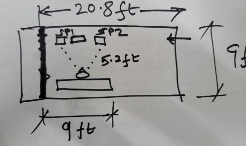

Using Denon 900HNE with Mission QX2 MK2 with entry level audioquest cables.Source is Spotify.Apartment listening area is as attch.Note thr listening area is compact and i cant place speakers any other way in the living room.
1) upgrade only speakers to one of these a) Super Denton
b) B&W 606S3
c) Dali Oberon 5
Any folks using Denon stereo amp and B&W 606S3 or Dali .
2)May consider Audiolab 9000a plus wimm combo or Marantz 40N with any one of the above chosen spkrs.
Dont plan to audition so leaning heavily on the folks here.
All in one streamer amp is my preference.
Thanks a lot !

For a room this size you may want to consider this : I have Dali Oberon 5s in a similar sized room (17x11 ft). The Dalis are back ported and the manual recommends a distance of at least 8 inches from the wall. I have them at around 15 inches from the wall. Even then, there are certain times when the bass sounds boomy.
My amp is Marantz PM7000n which is a DAC+ Amp+ Streamer (Spotify and Airplay, no Chromecast).
Thats valuable inputs as i cant spare more that a 6 inches from back wall.Not sure even if back ported wharfedale super dentons will work?

Maybe due to space limitations i need to consider sealed ,bottom or front ported spkrs
