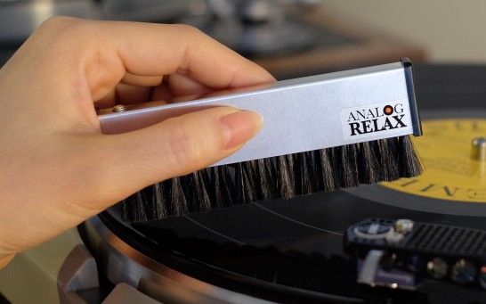

Thanks @Record Player . What about cleaner like this Silicon based :-
This is helpful for removing loose dust from surface but not from grooves. I use this to first 'pre clean' and then use distilled water/IPA/Colin mixture. Works very well.
