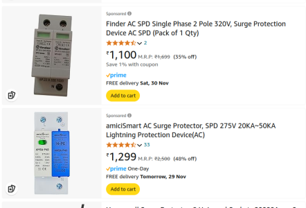

mbhangui, is surge protector also an option for protection against voltage fluctuation?
No. Surge protector will help you when you have insanely high voltage. It will short causing your house fuse to blow. It would protect your equpments like fridge, ac, etc which takes few seconds to get fried. However sensitive electronic equpments could be toast by then. Once a surge protector activates it is destroyed forever, but that is ok. Now days you get surge protectors that can be installed in your existing distribution box. These surge protectors have indicators when activated and can be replaced just by pulling it out.

EDIT. These replaceable surge protectors look like this

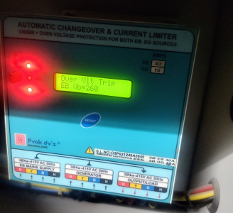

this is equipment they installed in my apartment per flat. Its happy to send upto 260V, over which it trips cutting of power supply for whole house. Last 2 weeks its been tripping (>260v) continuously in the night even after several complaints by society to electricity board.
You have been saved actually multiple times by this accl. Complaining will not help. The electricity board has every right to send you upto 262 volts as per the new voltage standards.

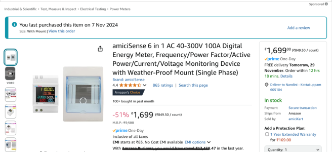

I bought this a few weeks ago. It was just to monitor the voltage and current. I should have waited…the one identified by Prem seems to offer monitoring of voltage and also protect against surges.
I have this got 3 years back and so lazy that I have not yet installed it. You have inspired me to install it. This one gives you every possible reading regarding the quality of power. This is a good thing to have.
The one listed by Prem displays only the voltage and current. But it's primary function is cutoff and safety. Your device's primary function is to display the quality of power. It is also a good thing to have

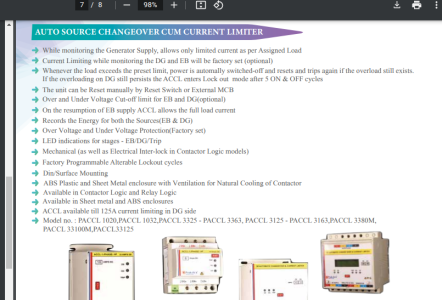

I believe amic is from Taiwan. Most of our semiconductors gets manufactured there. I have not come across these devices from Schneider/Siemens or any one from US/Europe. However there are indian manufacturers making what is called a home protector. These are large iron clad boxes with potentiometers inside which can be adjusted to set the cut off voltage. In one of the reply from @muralimmreddy in this very post, I have come across an Indian brand which can be installed in buildings which have generator backup. It can simply replace the existing accl. These accls are manufactured by companies like L&T, vguard, Havells, etc. I'm going to suggest this device for my society building. This is the device that he posted and it will protect your entire house.
mbhangui, what you are saying is one can have something similar for the whole building?
For individual flats. In buildings that have automatic generator backup, there is a device installed called Automatic Source Changeover and Current limiter switch. It is called ACCL in short. These accl switch the output to the generator when the main supply goes off. Every flat has a ACCL switch in the meter room. My building has it. But what has been installed in my building are ACCLs from L&T, Havells and vguard. None of them have high voltage protection. Now this device that Murali posted is a surprise to me. It has over voltage protection. I'm trying to get details of this switch online. If the cutoff voltage is adjustable then this is the best thing. You just have to replace the existing ACCL in the meter room. So far I have not been able to get details. I will write an email to the company and find out
EDIT: Unfortunately it looks like you cannot adjust the high voltage setting. It is factory set (point no 8 below)
