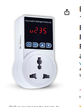

Then that amic device is what you can put. It has adjustable low/high voltage cutoff and also the recovery and action time settings.
I would want something at the main board for a single phase. The Amicismart seems a better option.
Any idea what technology is it using to ensure voltage cut off and overload protection?
mbhangui, how’s something like below?
I find this company products impressive.
Hi Prem,
From the specs I cannot determine if the high voltage cutoff is adjustable. It seems that it is fixed at 280 volts.
They all use a microcontroller to sense the voltage and power off a relay to cut out the supply.
