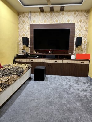

Please check the setup and sub placement
The Subwoofer positioning is not ideal. Try placing it near the right corner or Bang in the middle..
I will try to reposition my sub today, and see if it makes any difference.

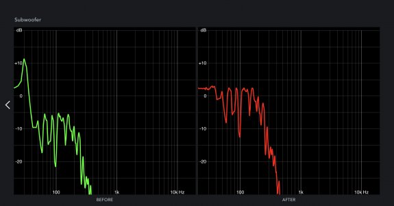

Here is the result after I did audyssey

Any option to place the sub near the sofa right side? I think that can make a difference, else you need to follow the subwoofer crawl method in order to find the best sweet spot.

Is it possible to move the L-sofa about three feet away from the back wall?
If possible, try that and re-run Audyssey for that position with the sub in front of the Centre speaker...

Will try, but the problem is if I move the sofa a little ahead, it will block the doorway...
That's not too bad at all. However, we'll get a better idea if you post a complete sweep from 0 to 20K Hz with your main speakers in the mix. That way, we'll get an idea if there's any bass cancellation/peaks when the sub interacts with your main speakers.

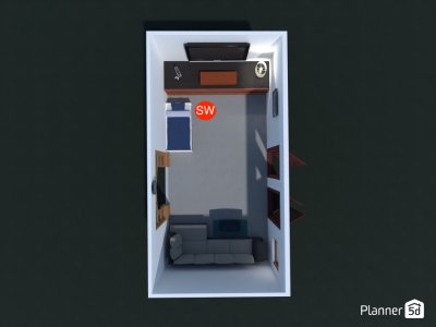

The room size is 9x11, listening position is against the wall as shown in the image.
That's not too bad at all. The SVS should have absolutely no problem shaking the room to its foundation. I have a Mission QX-12, which is a much less accomplished and less powerful sub thab the PB1000 Pro, installed in a 22x12 room and it provides excellent slam. For that matter, a single one of my REL T9is with a tiny 10 inch driver and 300Ws can provide adequate slam for most occasions in the living room which is approx 450 sq.ft.
Therefore, as suggested -
You might require umik1 and rew software to know which is optimal position of your room. This is the first step toward getting nice bass. Minus 10db response before audyssey obviously tells you this is worst position for your room. And don't get carried away by the after audyssey graphs. You need a friend or assistant do check the right position for your room and this might take one weekend or two to decide what position sound good. Get umik1 asap and a close friend who is interested in hifi
