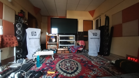

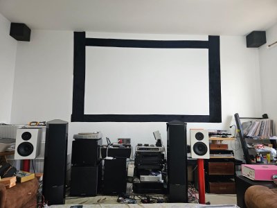

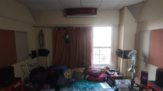

Rooms will always cause speaker placement issues. I will give you my own example. I use a spare bedroom as my den. This room is 13ft x 12ft. One end of the room has full length sliding windows. I sit with the back facing the windows. At the other end is a small bathroom 6ft x5ft. So the room becomes L shaped. A large 65" Plasma TV which has the front made of real glass (not the LCD, OLED kind of screens). The speakers which are placed have an asymmetrical position because of the L shaped room. Practical constraints do not allow me to place the speakers elsewhere. Regardless of acoustic treatment, speech in the room always sounded good with the reflective TV and the rear full length windows of glass. Stereo however was a different story. Even after few gruelling hours of speaker placement nothing much was achieved. The sound always stopped at the line where the TV was placed. It was only after doing acoustic treatment have I been able to get depth in the soundstage where sound goes even behind the tv and also have the speakers dissapear.

View facing the speakers
View facing the sitting/lying down position
