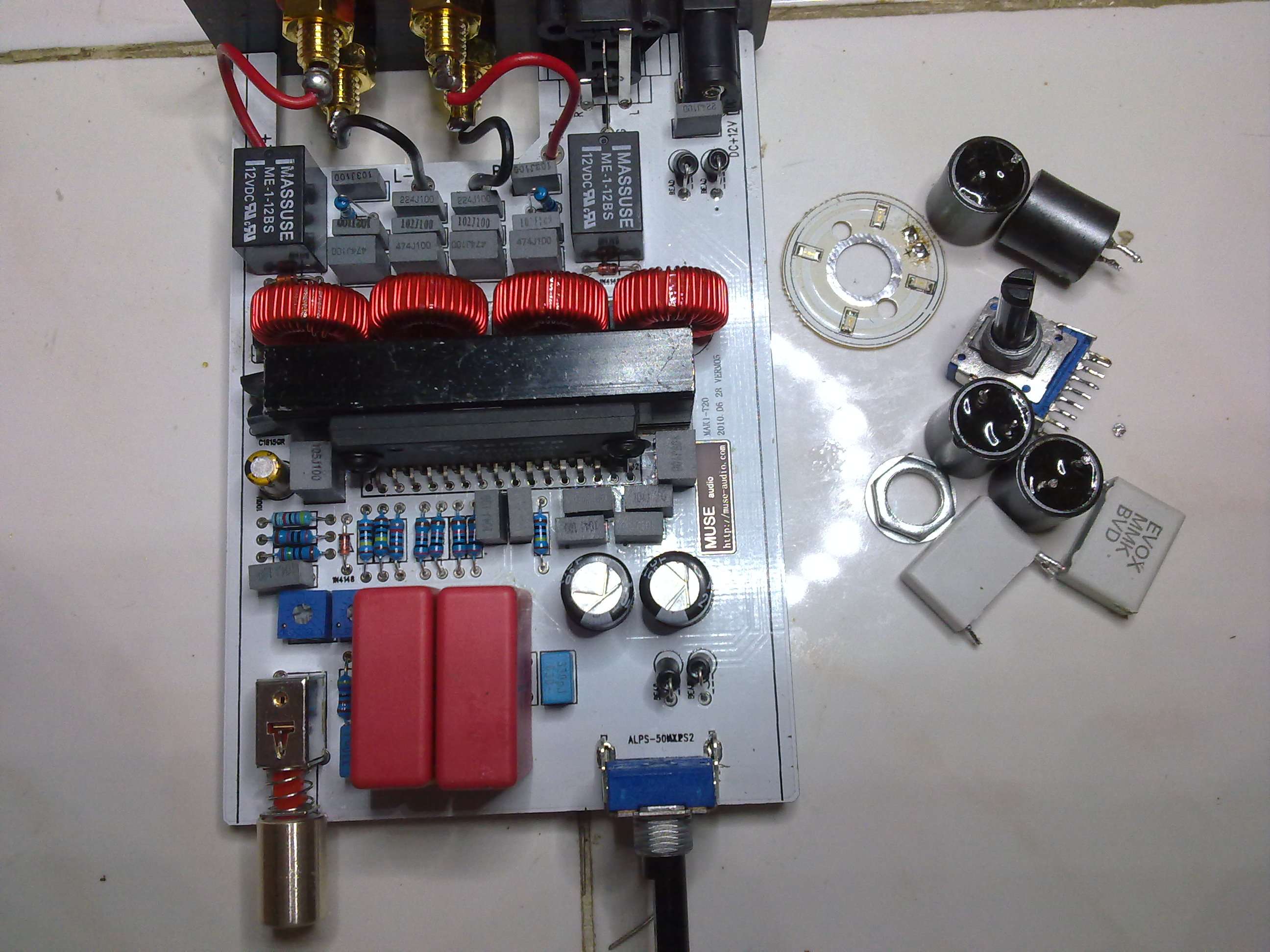

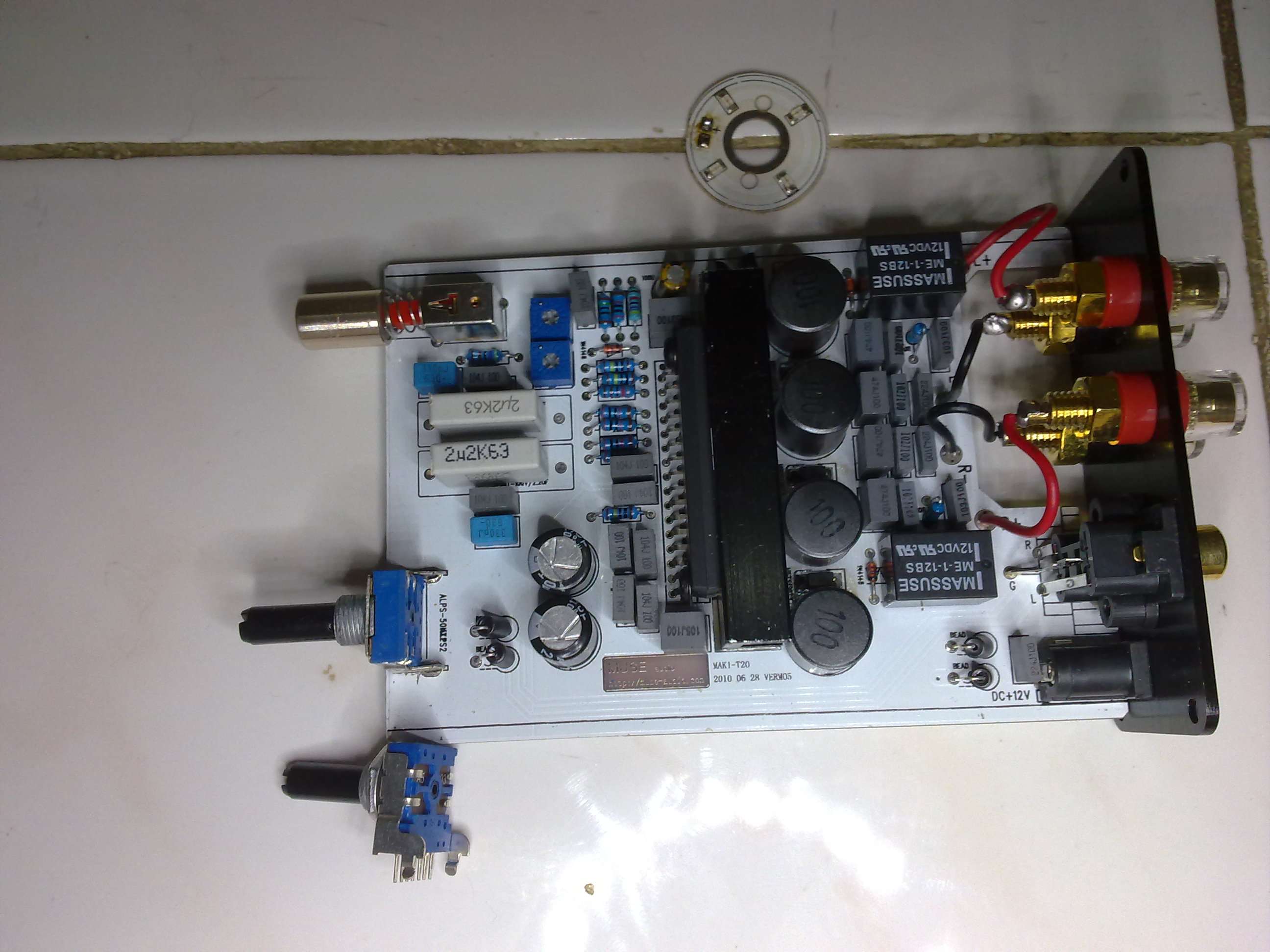

So this what you get for the MUSE after upgrade of input and output components. Seller did a nice job of sending new pot to replace the damaged one. New trick was tried to remove old one from the place.
Internals of MUSE 2020 with new pot arrived.

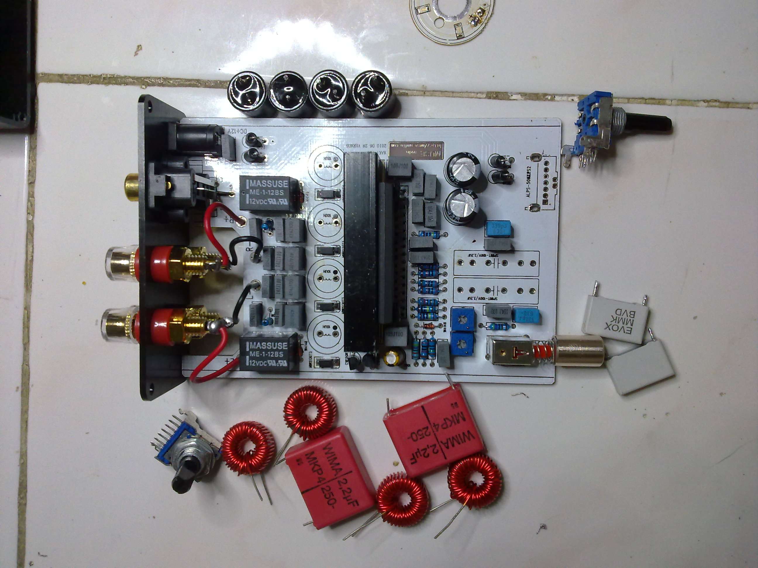

Input caps and output coils waiting for get in.

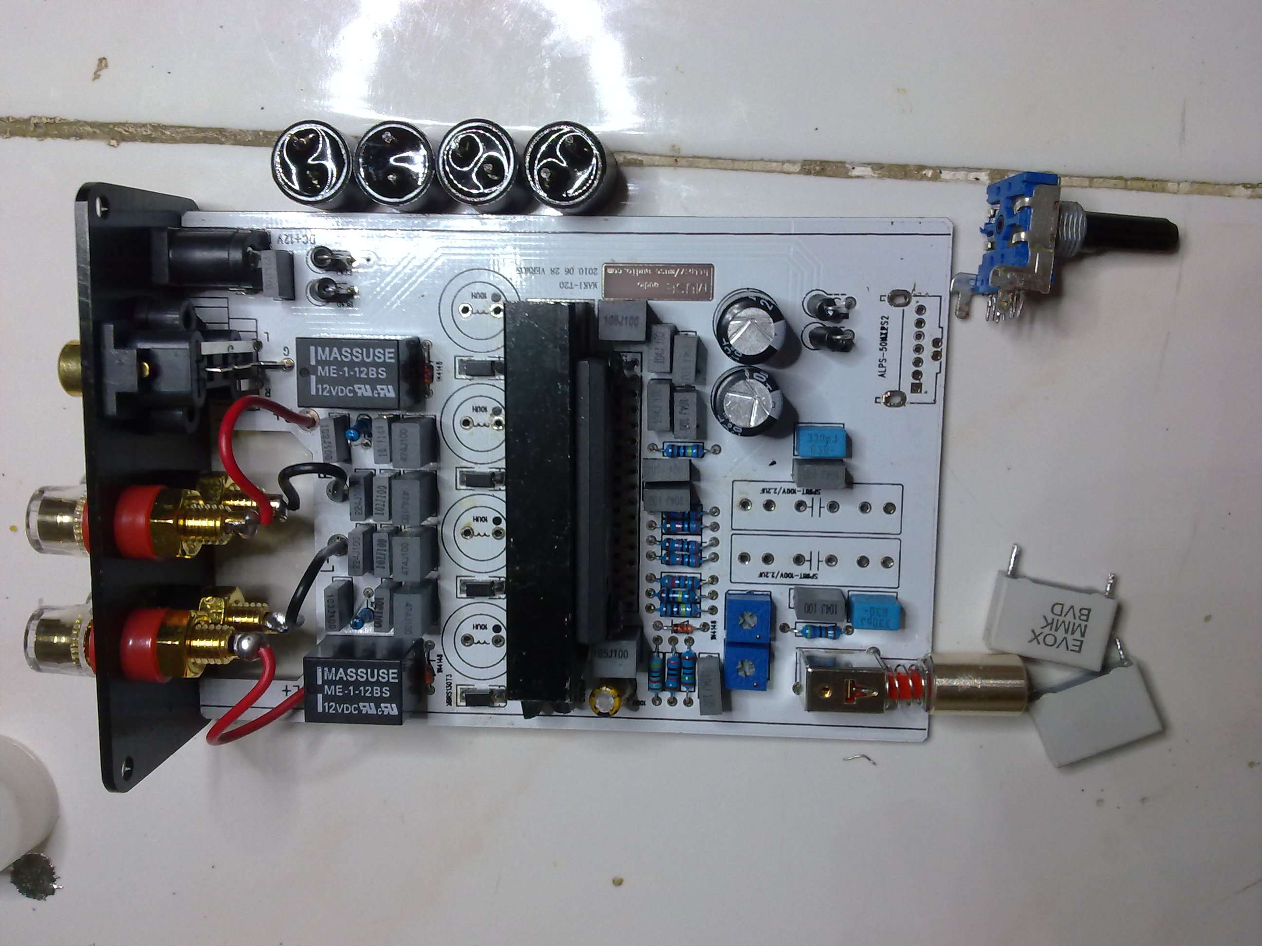

Old stuff out
New stuff waiting
All done, get set go.
Amps is singing nicely and volume pot is nice, neither flimsy nor shaky. Really good and confirmed our Custom Babu's ruined it.
Sounding nice, wait till I edit this post again.
[Edited]
How is looks?
No change in the look apart from missing nut around volume pot is in place with new pot provided by seller. So lights are now firmly attached to front plate and exactly behind knob. Thus making equal light below knob.
How it feels?
Now volume pot is not shaky, get a feel of firm and solid knob while changing volume.
How it sounds?

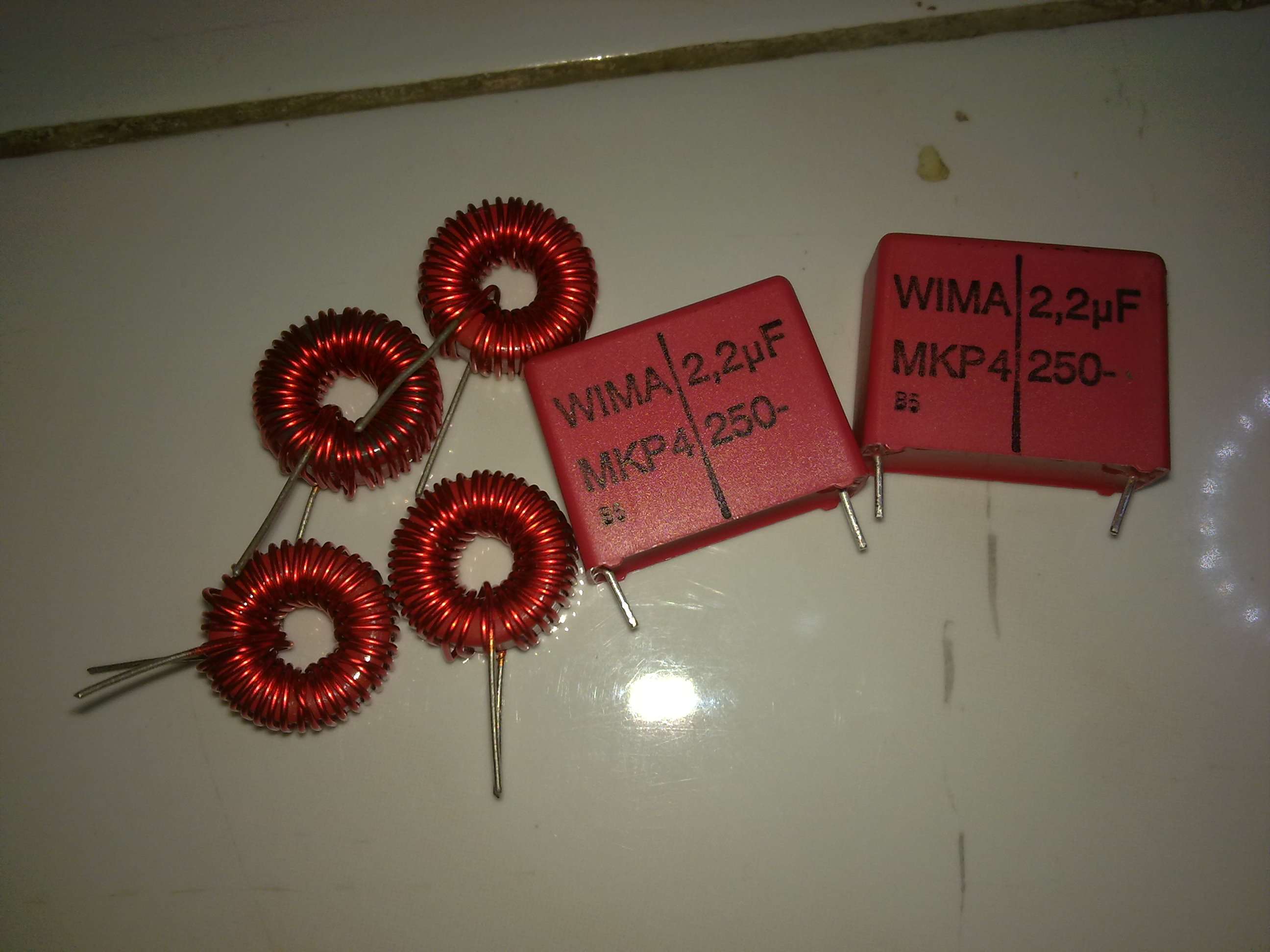

Earlier coils as I suspected were not even ~1amp capacity, lesser or equal. With new 3A toroidal coils from arjen_helder, bass stood firm at high volumes too.
With new WIMA MKP caps now all kind of sound are little mellow but clear, specially HF. Though details are present its not piercing ears. Mids are smooth, highs are clear and detailed. After all this is all TA2020 into its full glory. Now I like it much and say it sounds better than 2024 based amp.
BTW now it has low leakage of RF noise as radio is catching less noise, thanks to toroidal coils over drum based shielded coils. Now listening more and more using CDP as well as TT.
