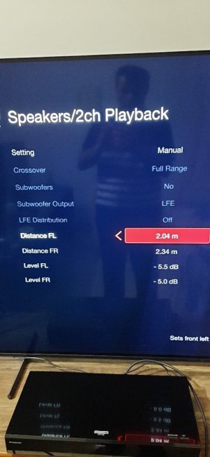

Audseey setip is setting these values is it good?
No reason to have your fronts at -5 and -5.5. What’s important is the relative difference - and the larger the deviation from zero, the most the DSP is playing a role and the more ‘unnatural’. It’s better to keep them closer to zero with the same relative difference, in your case FL at -0.5 and FR at 0
Of course depends on the settings for the other speakers
but why in minus? what if i set +5
