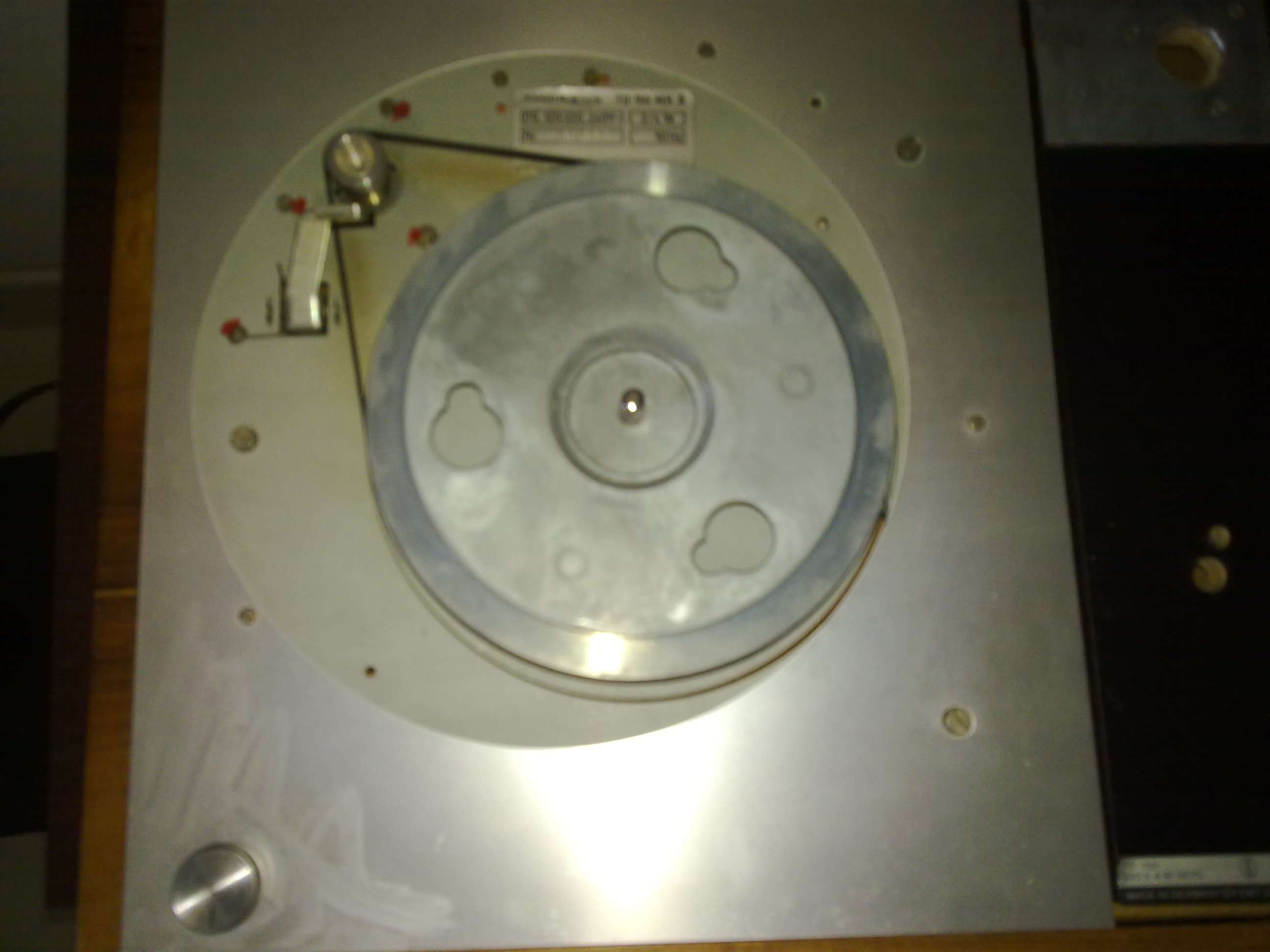

Dear Sachin, this was my wish to do lot of DIY in simplest TT. I wanted only little mechanical parts with least electronics in it. Thank you for guiding me. This is my Thorens TD-150, acquired some time back. This is Thorens TD-150 MKii - motor, platter and plinth, that's all!
Waiting for tonearm, mat, dustcover. Now works flawlessly without any play or motor noise.

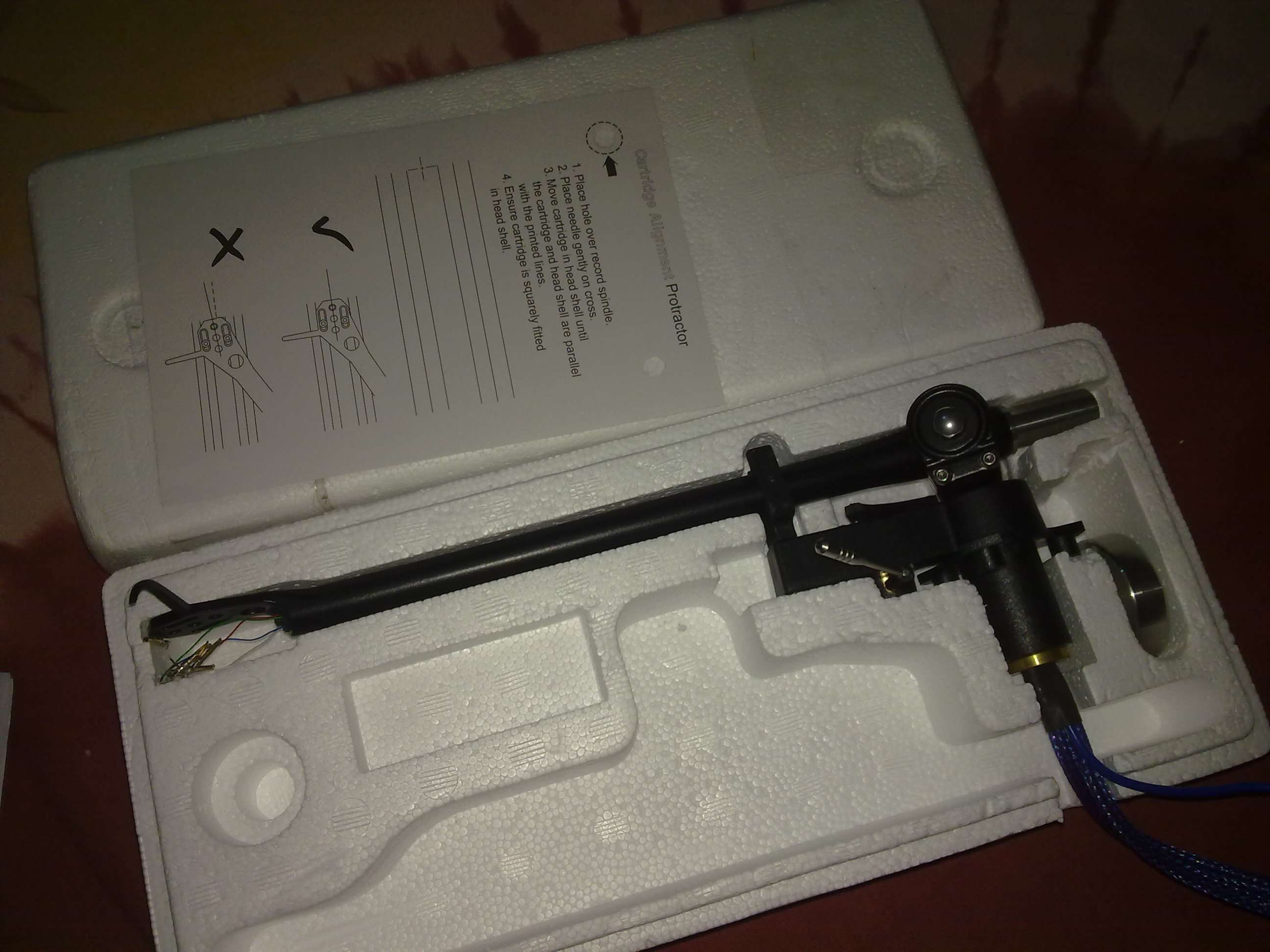

Okay so tonearm arrived, its Cabezon 301 ( Rega RB-301 OEM).
With Isokinetik Isotone tonearm rewired kit.

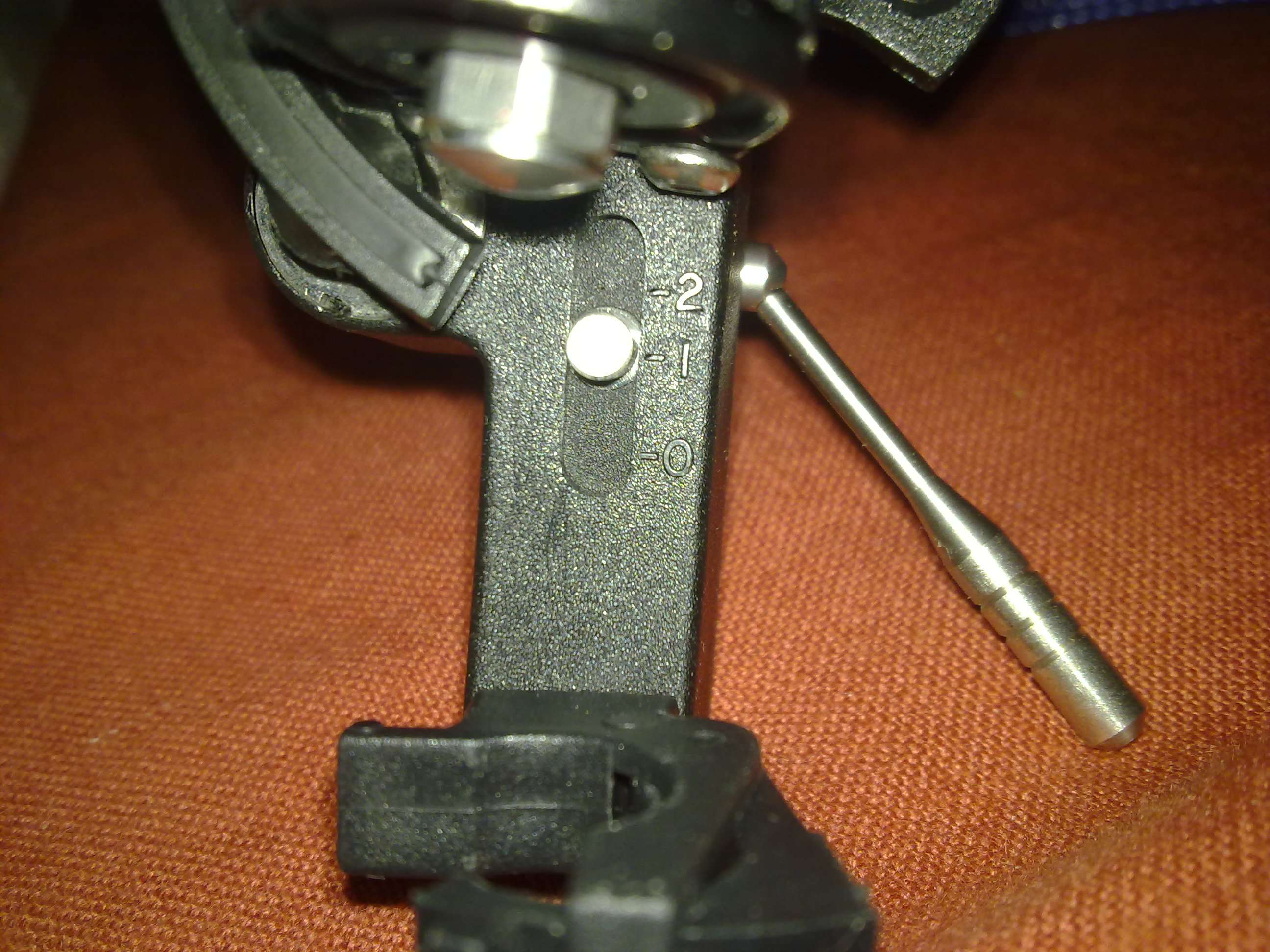

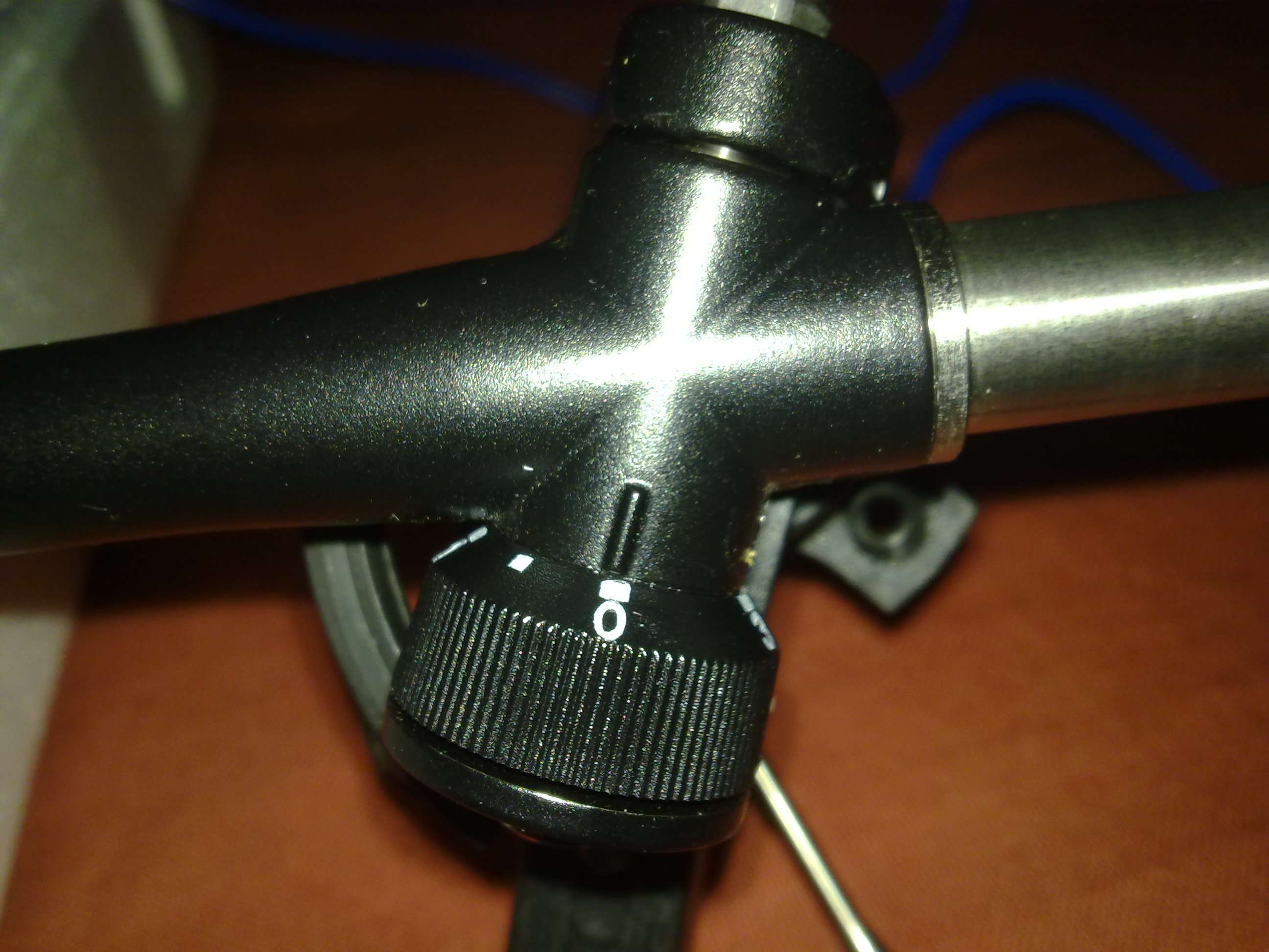

I am not sure what this (below) sets?
This is antiskate for sure.
That cannot be antiskate. That would be in the lateral direction and not in up-down direction. It must be downward force adjustment.
If you are talking about the slider marked 0, 1, 2 that's the antiskate setting. It means it should handle tracking force upto 2 grams. You will find that you can happily use even DL 103 at 2.5 grams. In case you want to continue using this arm for 103, headshell spacer to increase effective weight (and the corresponding heavier counterweight) are highly recommended.
BTW, is the Cabezon mod limited to the wiring or is there anything structural too?
Yes, it seems that big black knob is for VTF setting and slider marked 0, 1, 2 that's the antiskate setting.
You are correct!
Yes it seems only wire mod to RB-301.
See below quote from manual -
Cartridge tracking force adjustment
1. Ensure that the tracking force adjustment knob is set to the zero position.
2. With the cartridge permanently fitted in the correct position adjust the main bal-
ance weight so that the arm is floating with the stylus just 1mm clear of a record.
(This adjustment should be made with the anti-skating knob to zero. Note: Even
at zero there will be some small residual anti-skating force. Therefore it may also
be necessary to gently touch the arm bearing carrier to stop the arm moving out-
wards).
3. Rotate the tracking force adjustment knob to the required tracking force. If in
doubt it is usually advisable to use a tracking force that corresponds with the
upper limits of the cartridge manufacturers range.
Anti - Skating (bias) adjustment
Set the bias adjustment knob to the same number as the tracking force. Note:
This is not critical and a figure of 1-1.5g will normally be suitable for moving mag-
net cartridges and 1.5-2g for most moving coil cartridges.

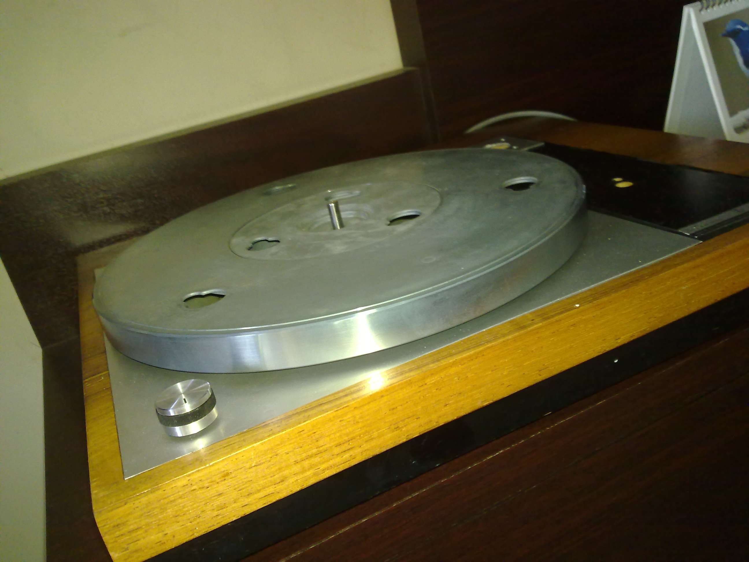

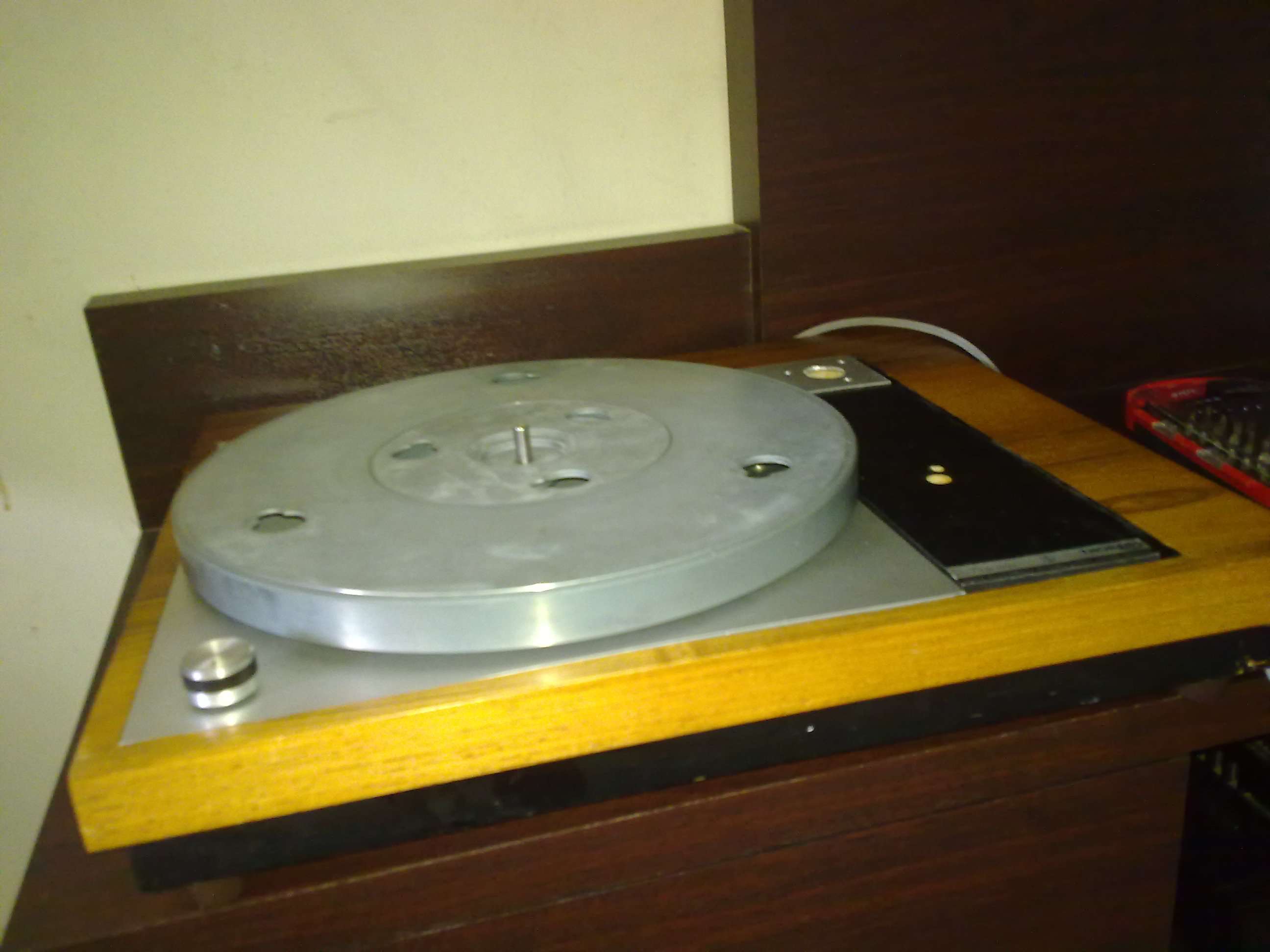

This rain also brought a spell of shower for me, and I got a Lenco I haven been dreaming for all this while.
I grew up listening to an idler wheel HMV Calypso, which my father bought in 70's, and it sounded fabulous, I still miss the sound which it reproduced.
So here is my Lenco GL78. Thanks to Sachin, Om and Joshua for their help and encouragement.
