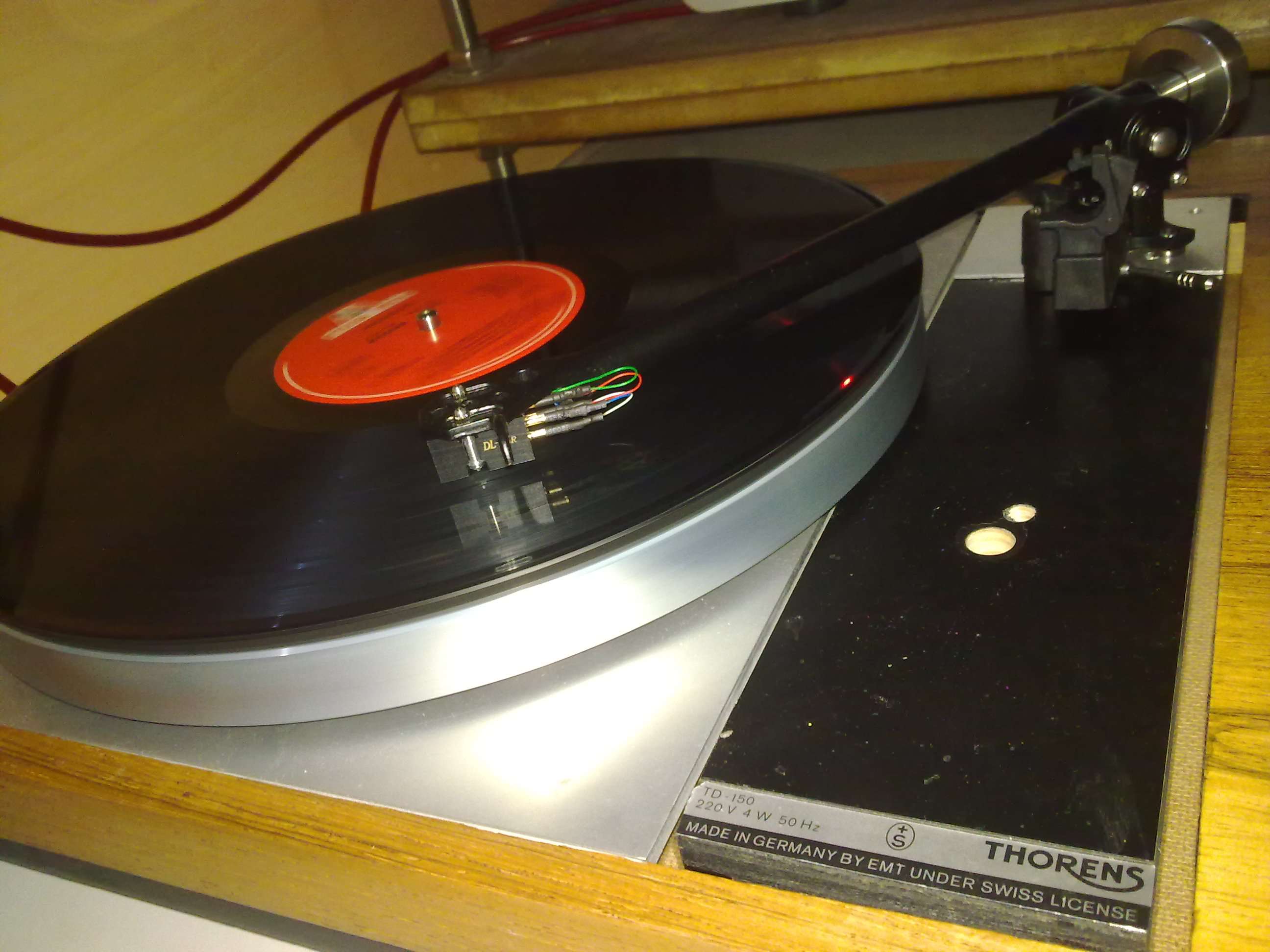

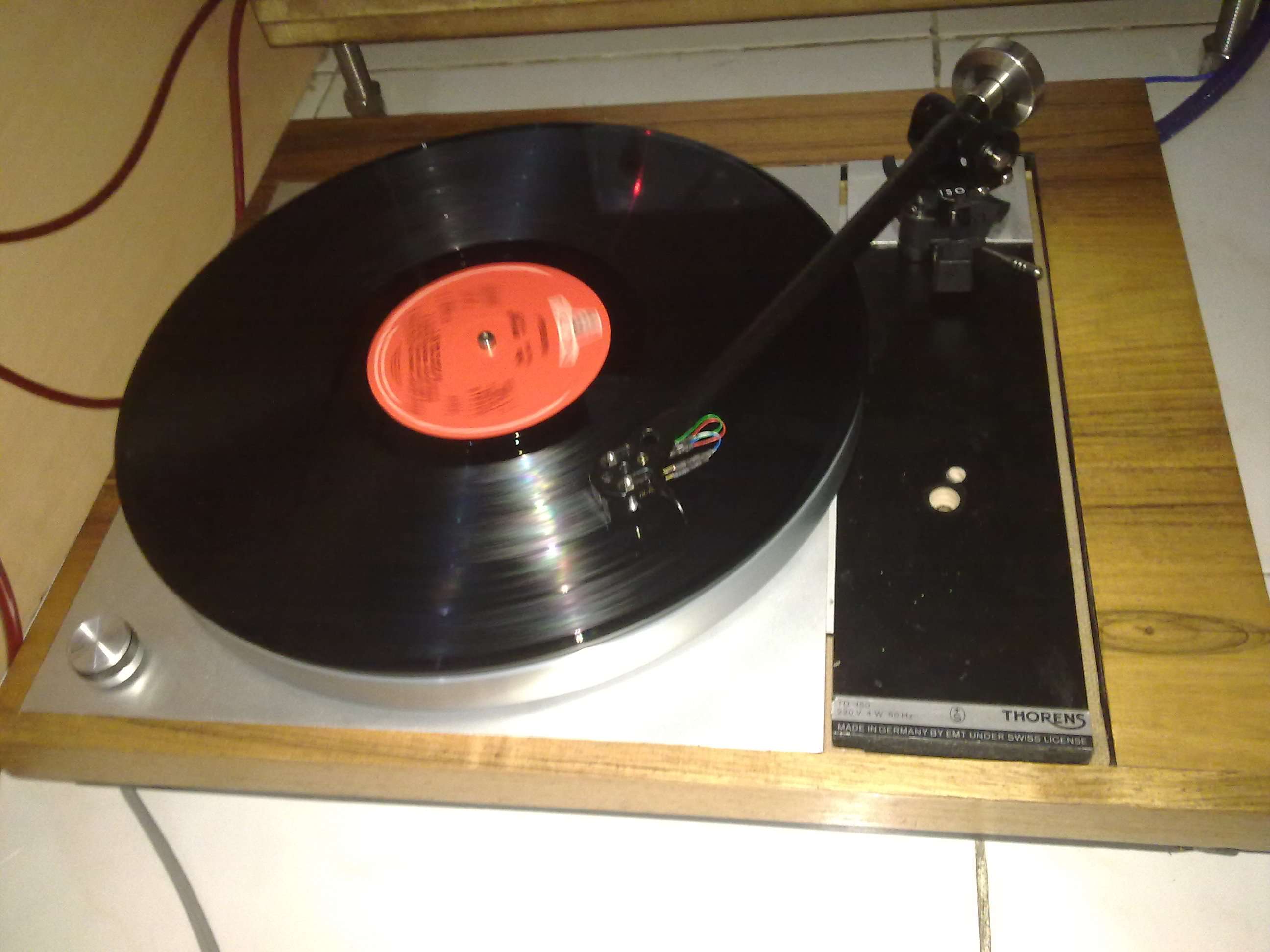

Thorens TD-150MKII Started singing. Thanks to Raga 301 with isokinetik isotone tonearm wire upgrade and Denon DL-103R. It took me 2 hrs to define markings on reworked tonearm board, drilling. Worked tonearm wire soldering. Verified ground wire and other leads.
Well defined tight bass and full throat vocals. Not to mention HF is crystal clear.
Now I will work on this for wood polish, platter buffing and other visual aspects. I am planning to add 3-pin wire to make earth ground to main plate and 16-pole AC motor. Because at full volume I can listen faint hum (which is IMO normal), goes away completely by touching to top plate near platter/starting knob.
